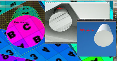

At the screenshot there are clearly visible triangles which are not visible after using TIG's exporter.
If this is the ray epsilon issue this cannot be set in Octane plugin - it is not available there.
Geometry issue - ray epsilon ???
Yup, it's a ray-epsilon issue.
Looks like your geometry is way too big.
Right now ray-epsilon is calculated automatically based on your camera pos, target and FOV.
I'll try to figure out how to overcome this before releasing new build.
