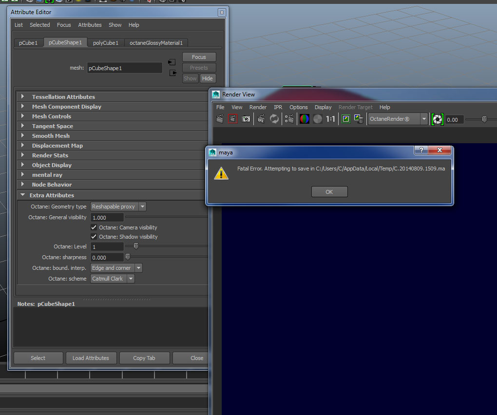

Hello, I get this error when trying to render an object with Reshapable proxy settings.
1 Created cube
2 Hit 3 on keyboard to show smoothed version of the object
3 Change geometry type to: Reshapable proxy
4 IPR Render
No problem at this moment when the "Octane Level" is 0.
Octane renders the cube as usual.
As soon as I use the slider to go to level 1 or 2 or 3, etc Maya crashes.
Fatal Error. Attempting to save in C:/Users/.....
Maybe I am doing something wrong.
Thank you in advance for your suggestions.

Sorry,
I'm using Maya 2015 and the latest Octane versions
Maya 20.4 - 4.5
Standalone 2.04

Just in case anyone has the same problem.
I updated the Nvidia drivers and now it works.
