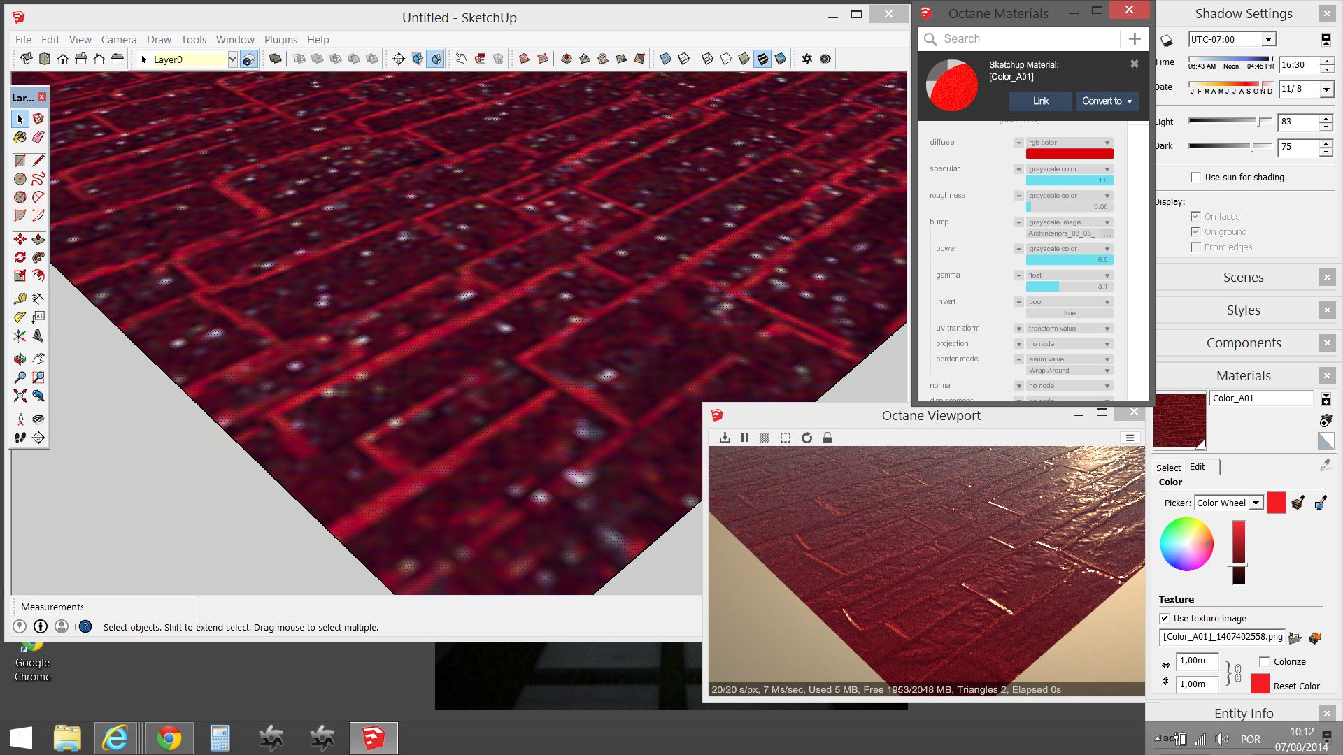

Re: What is the problem with bump ?
Postby val2k » Thu Aug 07, 2014 4:32 pm
val2k Thu Aug 07, 2014 4:32 pm
Tryed both ways easer and harder, but still can't get any bump effect in viewport. Any adjustments affect only preview in material box:
