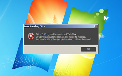

Have re download 1.55 installer and choose the 2011 64bit install path and double check all files, all is fine but error stills shows up. Not sure what this could be.

I got 1.55 working but the card still not work, is it unsupported at the moment.

No, it is supported, but you need a recent graphics driver. Which one do you have installed?MaTtY631990 wrote:Hi Karba

Do you get the GPU rendering in Standalone 1.55? Do you see any error messages in the log? (sorry, I don't know if the Octane log can be displayed in the plugin)MaTtY631990 wrote:Hi Karba

the standalone version works fine and without any issues. Also graphics driver version installed is 337.88. As far as I am concerned the last plugin release before version 2.0 is 1.53a, meaning of course it is unsupported unless I upgrade to 2.0, which means it will perform slower.
