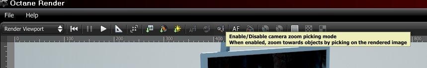

I may be wrong, but I thought the Icon at the top sets the zoom object and resets the pivot point. No?

8Eggar8 wrote:I may be wrong, but I thought the Icon at the top sets the zoom object and resets the pivot point. No?
whats that button , the AF button ?
