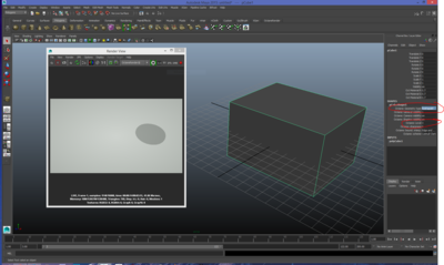

I found the Level parameter in the Shape Node. Is this information in the manual?

From what I just learned, while you are not rendering, if you choose Geometry type to be 'Reshapable proxy' and set the Level to 3, you should get subdivisions. I didn't see this in the manual anywhere, nor the forums. I had my post up for a long time with no one responding...I'm glad this info is finally out there!
