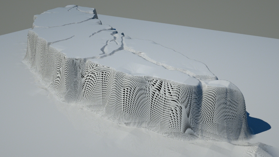

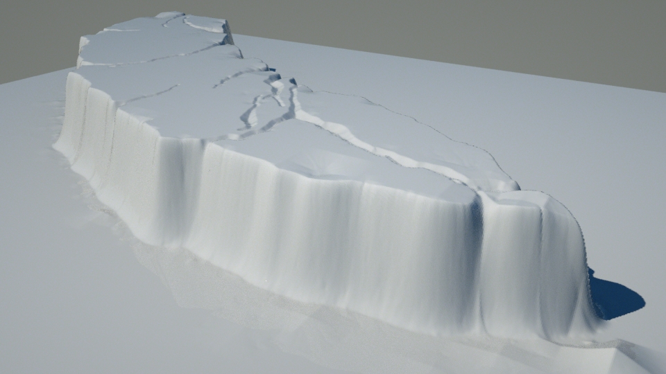

There is some issue with displacement when mesh scale is different than 1 or transformations are not freezed and geometry type is other than global.

Scale = 10
Scale = 10
Scale = 1
Scale = 1

These artefacts might just be a ray epsilon issue. Have you tried increasing it?
