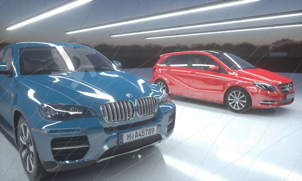

Is there a way/function how we could avoid jaggy (aliased) edges on bright surfaces (reflections on a car and bright black body materials) in Octane rendering?
I tried to cover it by adding some bloom and glare but no luck it's still very visible.

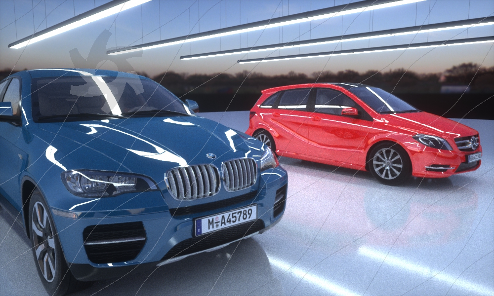

Ok i dialed back black-body material for ceiling lights (it was 5.0 now it's 1.0), added bit more exposure and adjusted gamma but i still see same jaggy edges on lamps and reflections.

All the scene looks a bit crisp. Perhaps you could add a bit of DOF effect, or change the "filter size" parameter (for example to 2.0) in the kernel to try to add more antialiasing to the scene.Lewis wrote:Ok i dialed back black-body material for ceiling lights (it was 5.0 now it's 1.0), added bit more exposure and adjusted gamma but i still see same jaggy edges on lamps and reflections.

Render at double resolution and scale down.
try the free OLMSmoother plugin - works really well in such cases.
