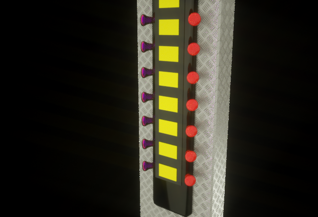

Hi octaners,
I'm building a scene with lots of lights, actually it is the typical carnival hammer or a high striker...
I've been struggling with all parameters of textures and lights with no luck at all, I can't get the lights to be turned on, with brightness emitting real light from inside the bulbs.
I checked the forum about the volumetric light trick following this post: http://render.otoy.com/forum/viewtopic. ... tric+light with no luck either. Also tried to make a diffuse texture with emission, but no visible light again.
The lights inside the bulbs are AREA LIGHTS if I add more power via 'Octane LightTag' to them all I get is to burn all surrounding textures causing Octane to make lots of noise (annoying white pixels) in the render.
I'm uploading the scene if someone can help (R15)
visible_light_c4d.zip
(707.17 KiB) Downloaded 253 times
This is how I would like to have the lights turned on, to be real lightbulbs!

post effect in octane? Also don't power that soo much. Will be produce fireflys due small objects+big power

Thanks for your quick response,
first, and to be honest it is my first project using Octane, so I'm kinda newbie, I'm aware of too many polygons and subdivisions, the project is sending 800MB to the card, too much, still it renders fine, I'll reduce the polygons and scale.
But all my worries now are to get this lights visible, I'm making this animation where the hammer hits the striker and then I'll turn all the lights on and off until the top.
here's a screenshot for now, it's quite nice but the lights:
any help will be appreciated,
teşekkür ederim

is it well for you?

Ok, yes it looks great!,
let me try this in my scene,
thanks, you rock man!
