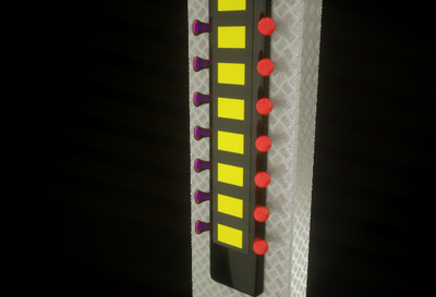

This is how I would like to have the lights turned on, to be real lightbulbs!

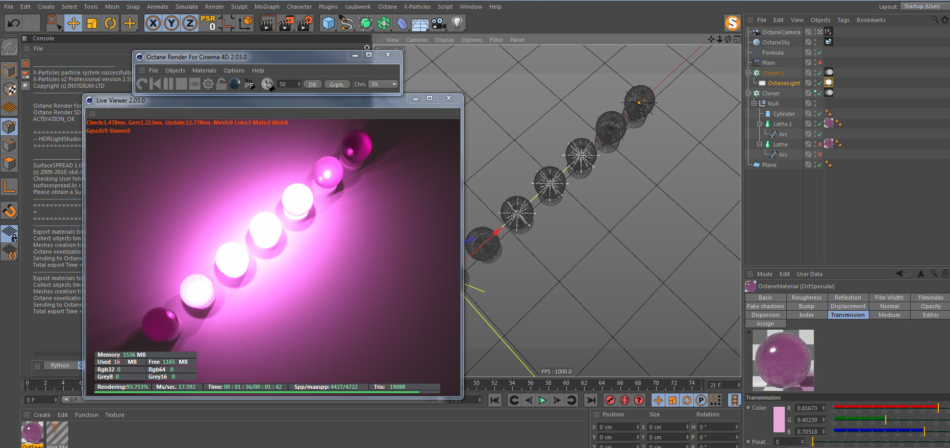

visible or volumetric light in Octane
post effect in octane? Also don't power that soo much. Will be produce fireflys due small objects+big power

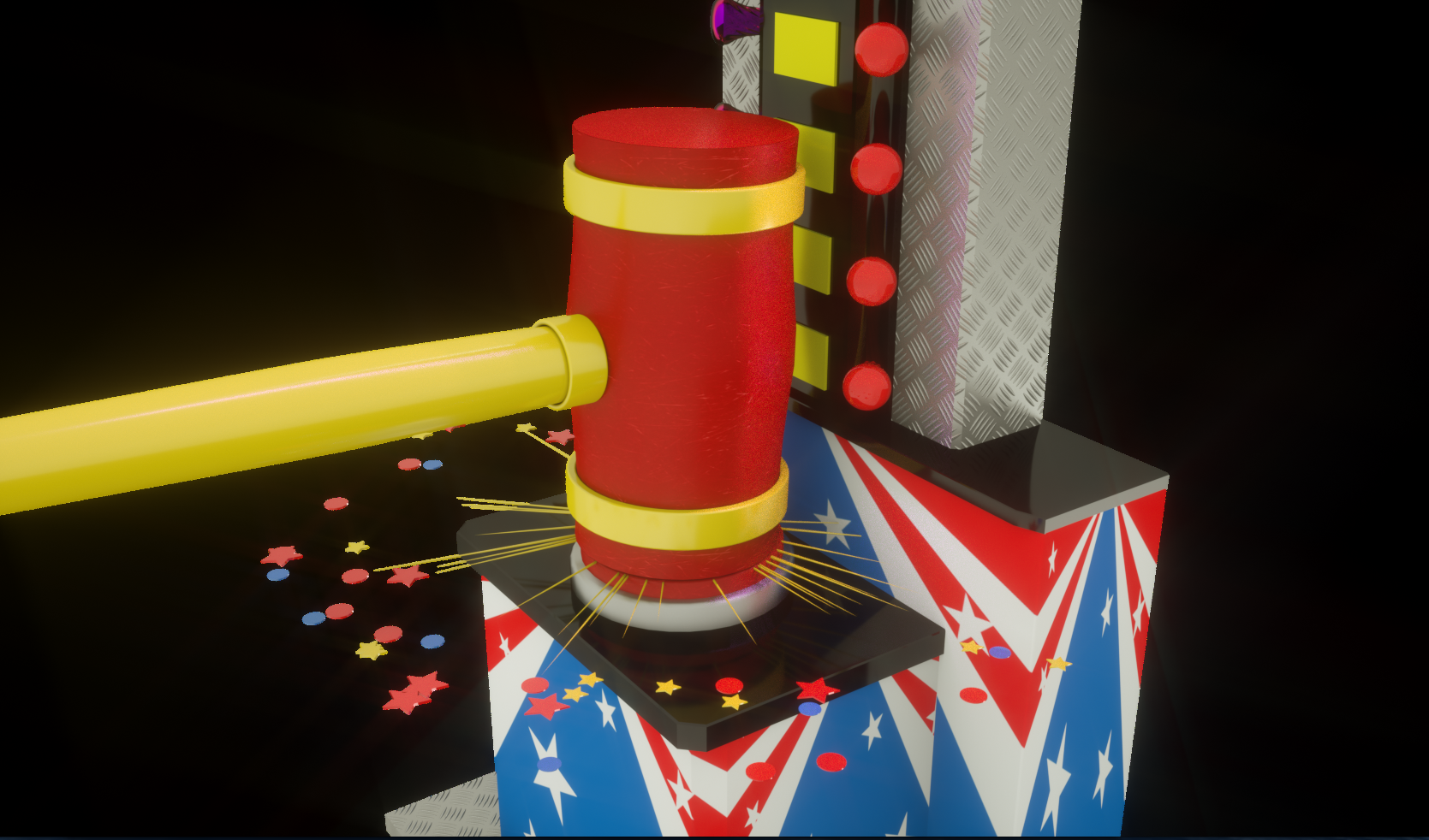

here's a screenshot for now, it's quite nice but the lights:
