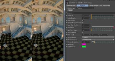

well, Octane 2.0 is out, but I can't seem to find any information regarding Oculus Rift? The usual stereoscopic camera makes my eyes hurt
Is there a way to distort pictures Oculus way within the Preview window (would be great if it worked for Cinema4d as well)

Use parallel stereo, set the IPD to .65 mm, use 125 degree thin lens camera + distortion at ~100%. Then use lens shift to swap the left and right views (on my Rift -.7 works). We're going to support the Rift more robustly via Lua. Please let me know if the prior info is helpful.

Hey there,
the best choice was to get something working and mimic it
So I got the Tuscana demo from Oculus Homepage and DLed Unity bundle which has fbx of everything inside. So I recreated roughly the demo and from my experience:
http://doc-ok.org/'s blog may answer many of your questions about VR.
Also it would be great the ability to go above 1 for Distortion, I'm not sure about the relationship between the Distortion and closeness to an object, but very close Distortion value 1 is not enough. (Maybe it's just CinemaPlugin limitation, can't tell)
- FOV is irrelevant for 3d-vision. Use it as if it was usual photo-related slider (in the demo there is 80-100 degree)
- Distortion values of 1 matches Oculus' Tuscana demo
- Parallel cameras and Sidebyside should be used as Oculus' SDK says
- Stereo Distance at 0 gives you "flat" picture and as it increases, objects closer to the camera get more shifted.
- Important is to mimic size of the Octane-render-window like Oculus does, fullscreen as it is today doesn't work. Window has to be smaller. I suppose, it would be best, if a black mask surrounding the picture would be added. Like many Oculus' devs do.

Distortion maxes out at 1, it is the FOV that is too low. To match the Tuscany demo, use 125 degree FOV. You also need to set the IPD at .65, not .25.
