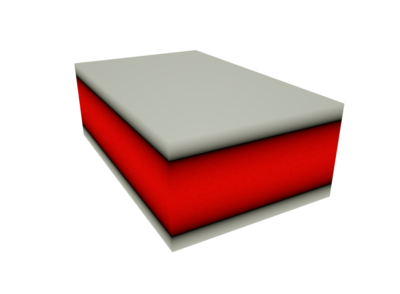

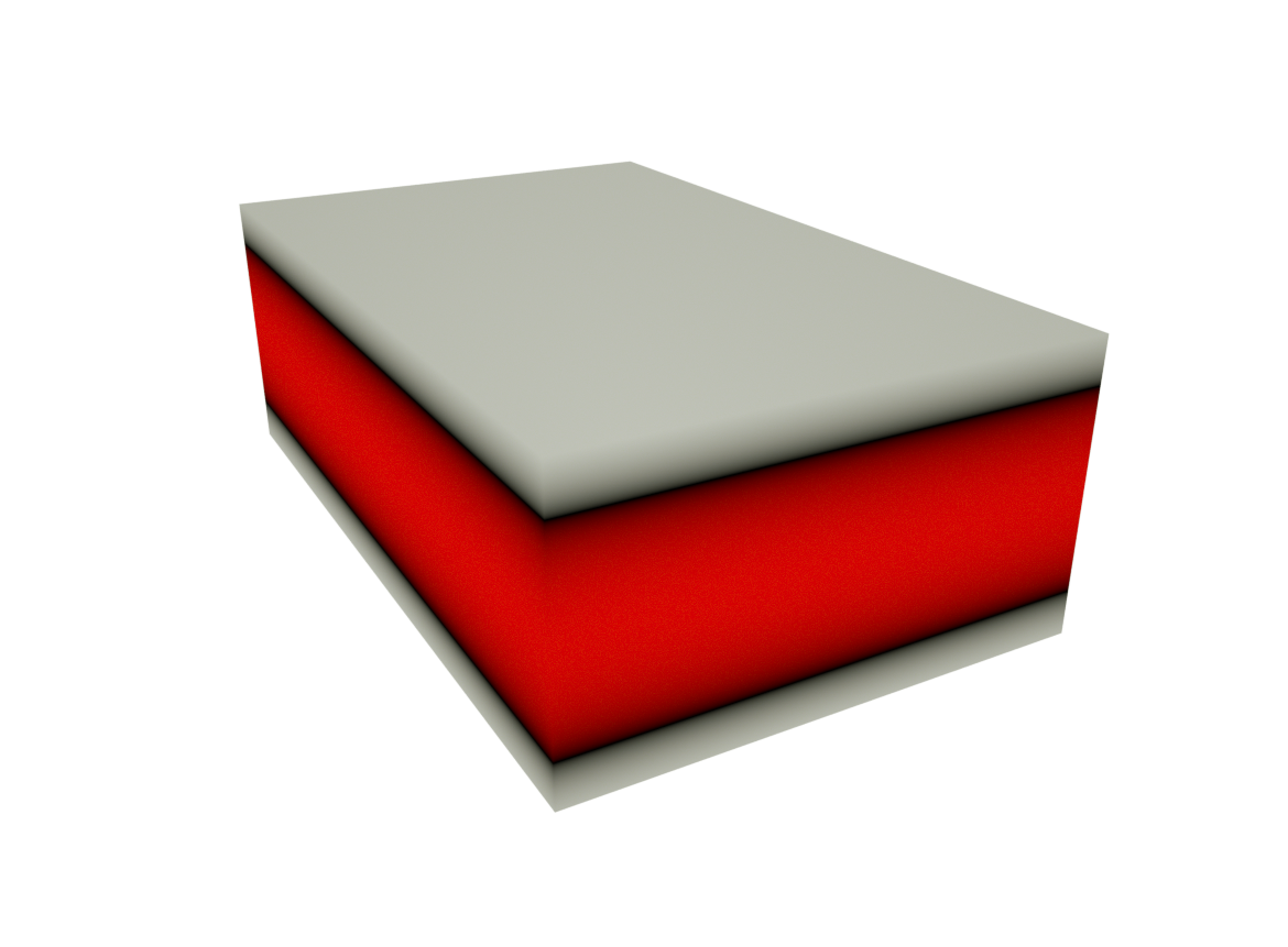

blastframe
Posts: 178
Joined: Wed May 21, 2014 6:01 am
Location: Los Angeles, CA USA
aoktar wrote:there
Hi Ahmet,
I downloaded the file and gave your 3D Gradient Material a try. I would like to create a material that fades towards the center from the top and bottom. I removed everything but the diffuse, which is now set to a black and white gradient. Can you tell me why the gradient includes red (and how I can remove it without using an alpha channel)? I tried using a mix material, but this resulted in a color also. My C4D file is attached.
Thank you.
gradient-xyz2.zip
(97.34 KiB) Downloaded 310 times
Posts: 16068
Location: Türkiye
no mistake, it's a bug. Fixing
