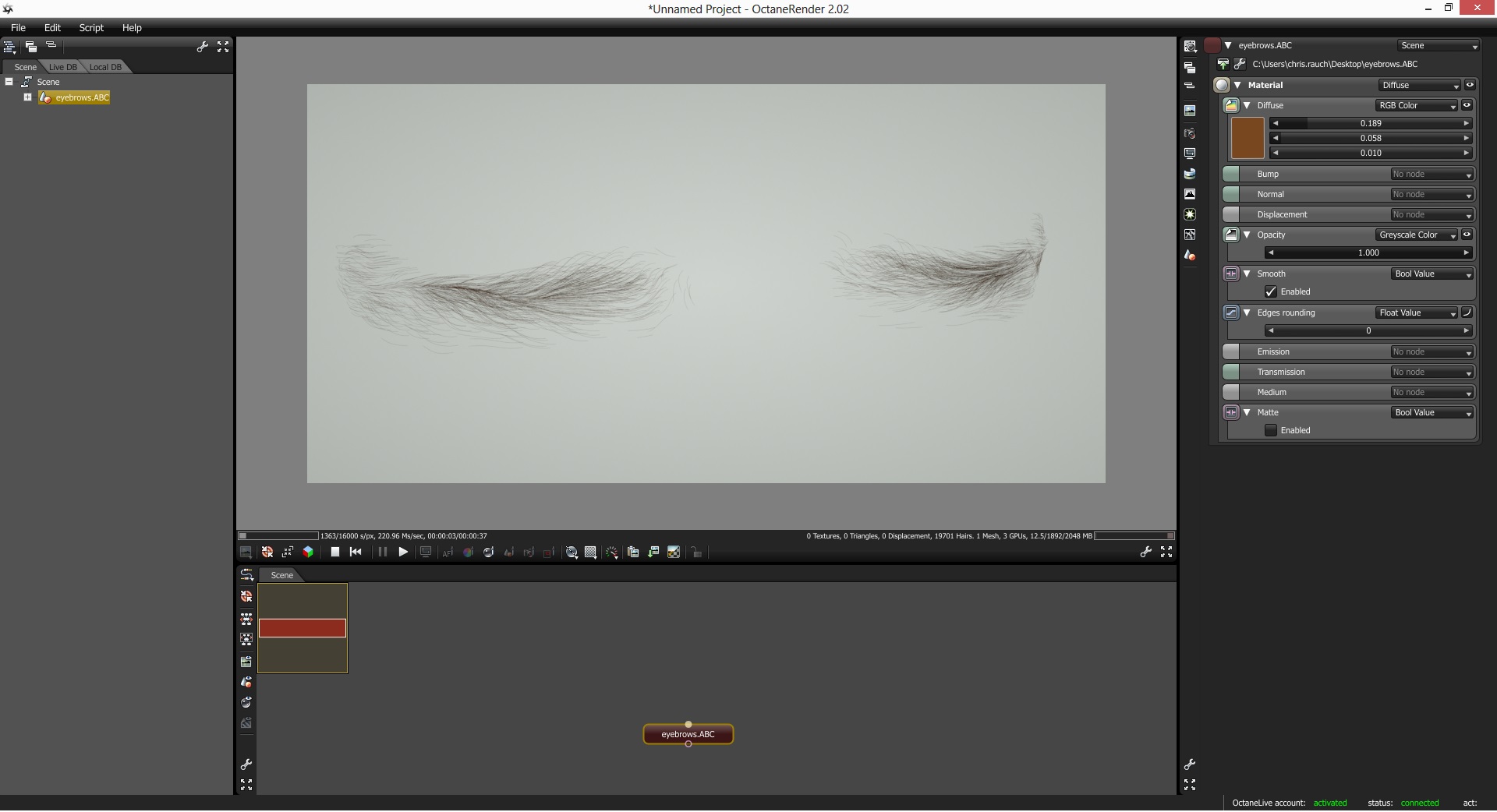

Hi, I'm trying to export a group of hair from 3dsmax through Ornatrix alembic exporter, the hair are exported correctly, except the thickness. If I DON'T specify the thickness in max, and then I export the hair, they come in HUGE, and the Octane parameter to specify the default thickness doesn't work!
Here is the file, if someone wants to take a look...

The problem is you cannot change the thickness. It doesn't matter what value I put in, it always looks the same... Can you confirm that?

It is specified, yes, but even if I don't specify it, the hair come in huge, and the thickness parameter doesn't do anything. Can we have a "override thickness" option box in Octane?FooZe wrote:Ahh, ok, sorry I thought the problem was that the hair was huge.
Yes I can confirm the default thickness does not seem to do anything for me either.
Is this the export with or without the thickness specified? (I'm guessing with?)
