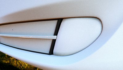

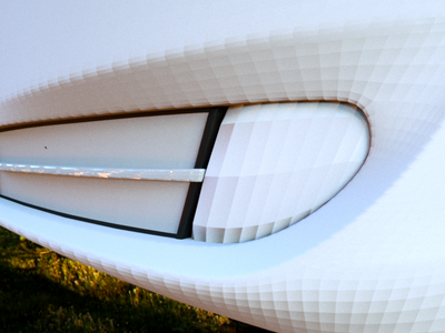

Hi, Karba! I do not know if sombody already reported this, but I've found this bug. Below are the renders of the same mesh with the same smoothing done under MAX 2014 Octane 2.02 preview and then imported as Alembic in Standalone 2.02. Defenitely something wrong in the Standalone picture, since the smooth is rough compare to MAX preview render. So, is it a bug or?
Update: It is working correct in OctaneRender for 3ds max® v2.01
Standalone (alembic)
Max 2014 preview
Max 2014 preview

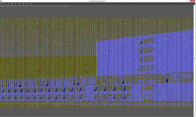

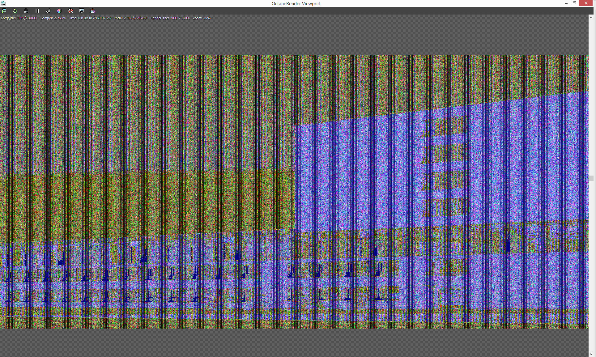

we got some strange issues with the frame buffer in higher resolutions:
the clone to framebuffer worked, the image also looked like it had to.
win8.1
nvidia driver 335.23
one gtx used for display, all other gtx 680 rendering, no memory overflow (all have 4 gb)
