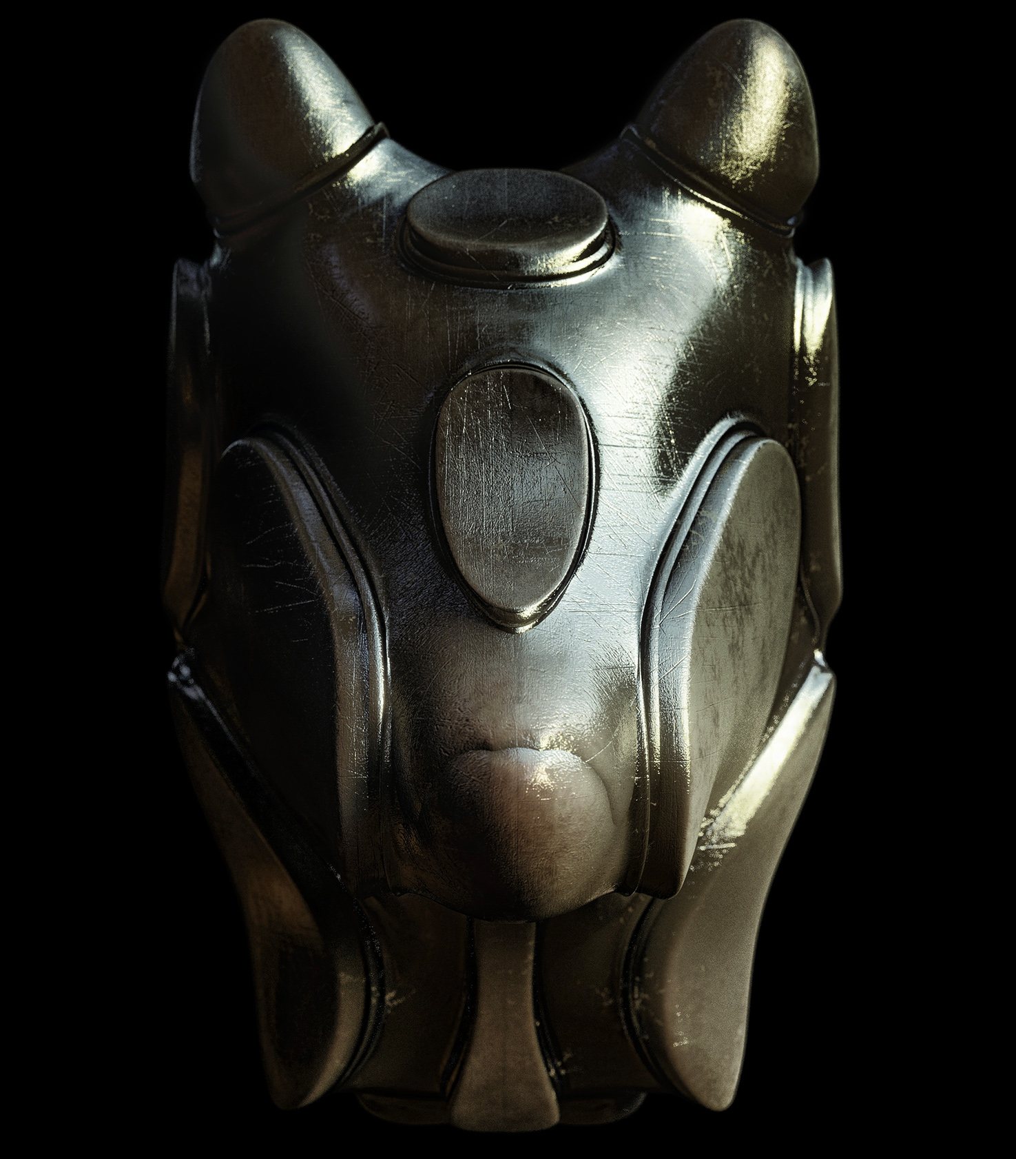

ElBloko wrote:
ChrisVis wrote:Did you paint the textures for that one, or does the scanned model come with textures mapped? Lots of detail and little dirt stuff there... or is it geometry? Or just a tweaked stone material?
The patina is made with a simple dirt texture node used as a mask to blend between two materials. Here as color on a diffuse material:

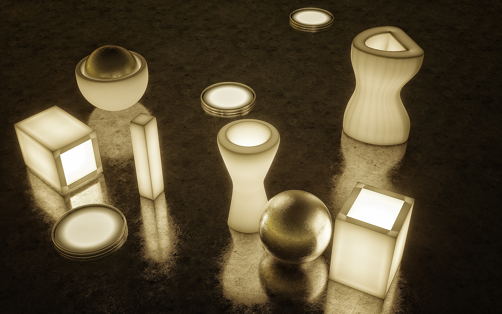

nice one, I actually enjoy working through the procedurals, results are usually crazy unexpected, something I would't even achive or think of doing in photoshop ..
here's my playground, dirt shader as texture in emmision - finally figured out how to get that lampshade look, and dirt, turbulence on bump, specular etc on the ground
bump is a jpg..

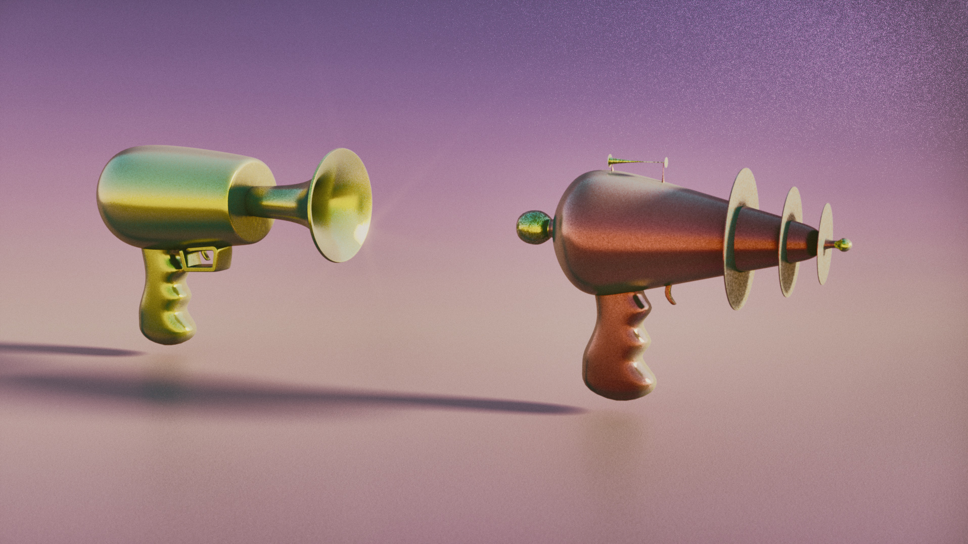

I love the metal on theese, I'm using this dirt with turbulence on diffuse and glossy modifed a lot
all procedurals..
love em :).. but you really got your deep in complexity, but that's how it goes once you start diggin into it
