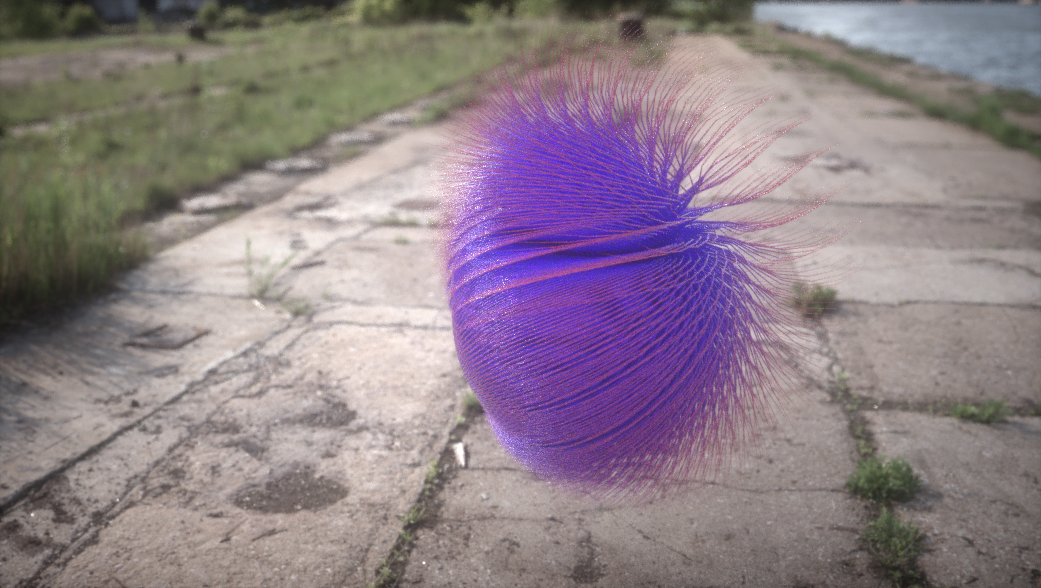

Hi aoktar,
I see the hair in the live viewer but not when I edit in Standalone or render in C4D. Am I missing a step?
hairball0000.tif
Windows 7 x64 | GTX670 | i5 2500k | 16GB
Cinema 4D
Daz3D Studio 4.6
Posts: 16068
Location: Türkiye
slash wrote:Hi aoktar,
no, we can't transfer the hair to SA. Don't forget to check my 2.0 samples. Hair is same on Picture Viewer as should be.
