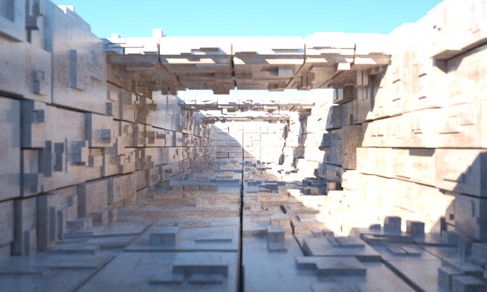

Just to make sure that we are rendering the same thing, that's how the trench looks like, when opened untouched in 1.55:
You may notice that the sun position has changed
To the why: We had to make a lot of changes in the ray-tracing and geometry code, to make displacement, motion blur, hair and rounded edges work. They introduce more complexity and therefor slow-down ray-tracing.
I can't tell you exactly why it's so much slower, because you can't profile CUDA kernels easily, but my running theory is: Since this particular scene mostly tests ray-tracing only (since the textures are trivial), it gets affected more by the slow-down in ray-tracing than scenes with more complex materials. We also had to modify the geometry compilation, so it's possible that we introduced a bug here.
