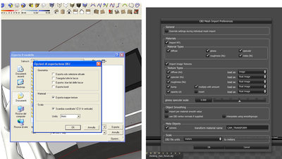

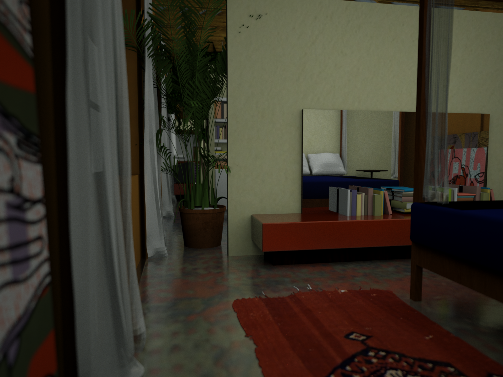

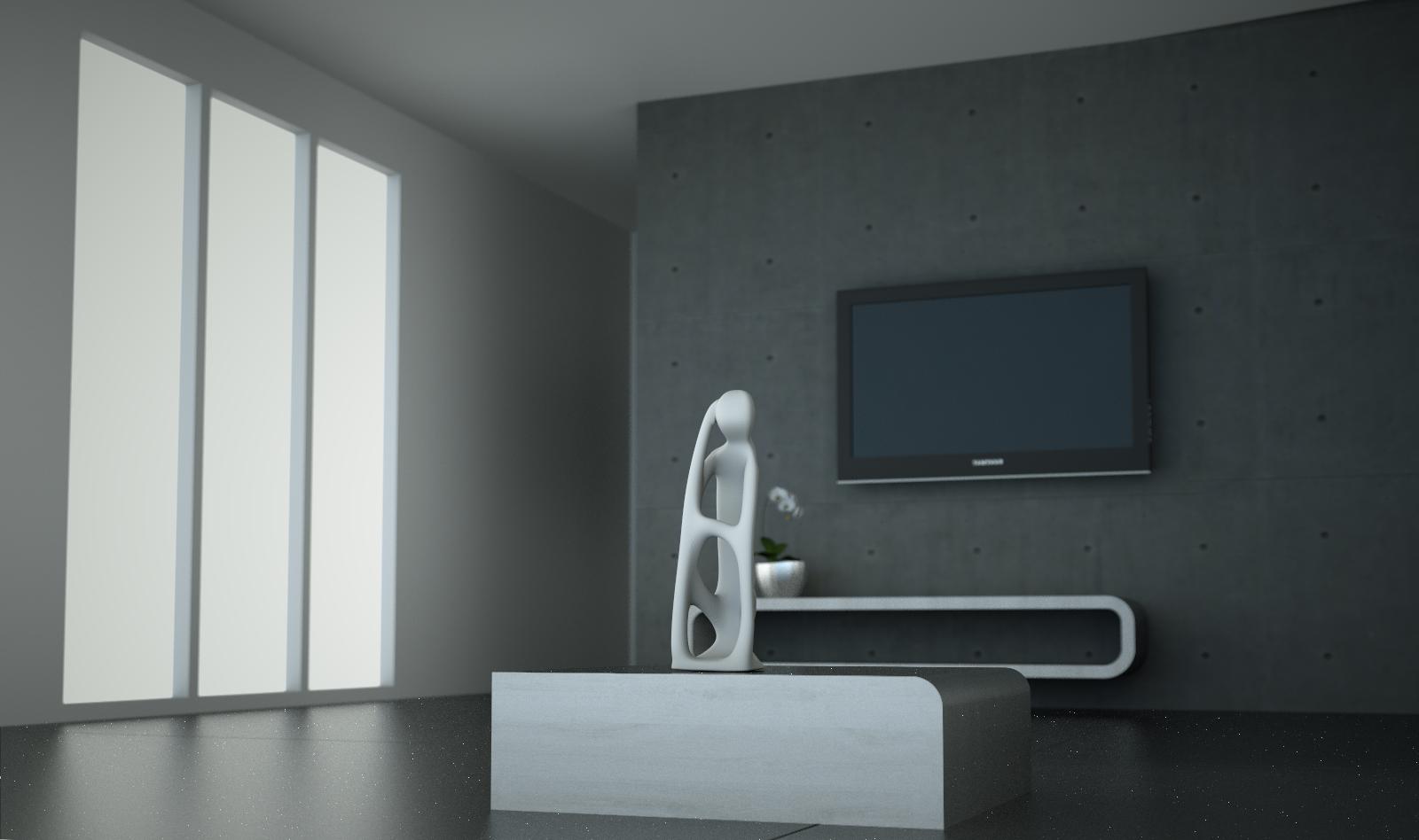

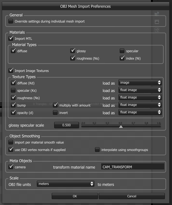

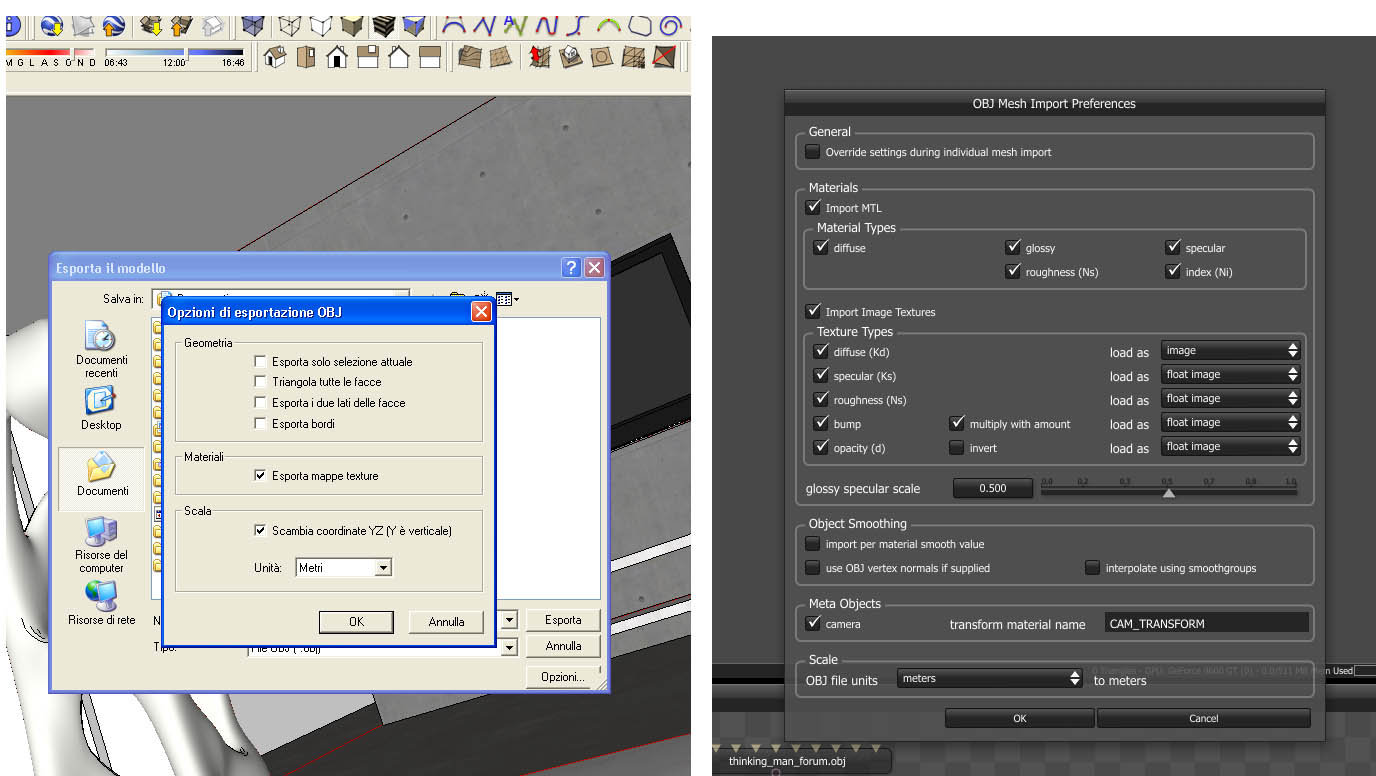

Hi Guys ... sorry for my english ... I did several tests to export from sketchup to octane and better results for the textures and patterns I got them as attached pictures. We also send a little test done with these settings.
It 's only two days I use octane, but already I love it :D

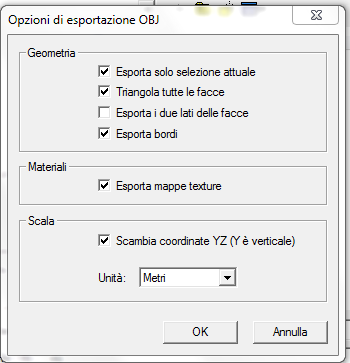

hi,
I'm an architect, not a rendering expert, and I only use a really small percent of the octane software features but the results are comparatively high in respect to other software I've tested before.
the only thing I really need badly is the glass shadows mapping.
that's the sketchup OBJ export way that I've set down after some different tryouts.
the original sketchup model is quite rich of geometry and texture but it work fine.
at only 1.3ms/s, in texture envirronment, it take 30 minutes.
bye....
andrea
