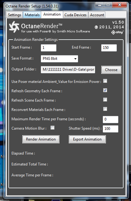

Hey Paul! sense i installed version 1.54.0.31 is got no camera animation
It's working OK for me. What Animation settings are you using (screenshot pls).
Paul
spartan00j
Posts: 351
Joined: Fri Sep 27, 2013 1:27 am
Paul
