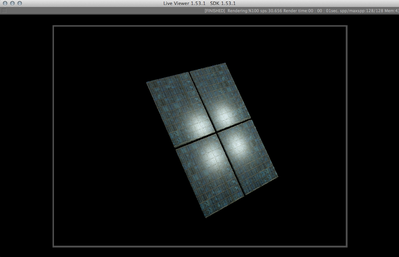

As you can see in the attached screenshot with 1 area light the reflection I get on the geometry is like having 4 different lights…
Same if I combine the 4 different plane in a single geometry.
Maybe I missed something somewhere or it's an issue…? I would love to understand ;o)

interesting - maybe You added some smoothing or smth that messed Your normals?

set phong angle to low

@glimpse thank you, but normals are fine.
@Ahmet well, once again the master wrote and yes I had to decrease at 10˚ the phong angle to make it work.
Thank you very much, as usual you are the man ;o)

np. Octane handles same angle differently
