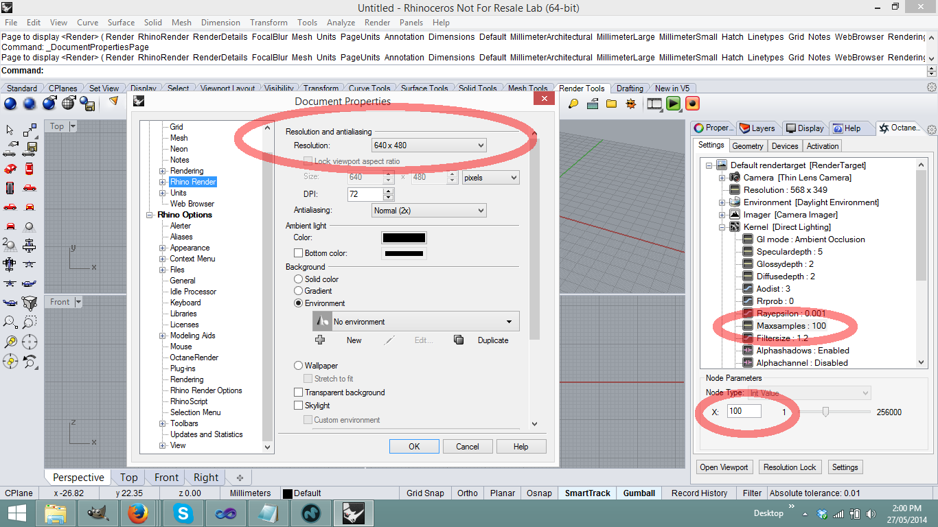

Why can not I set as the one that stand-alone kind of resolution I want? When I want to make a movie and octane use as a rendering of engine, I must wait until every frame 16.000.
I would like to know if there is a way to set these parameters.
I downloaded version 1.50
Thank you in advance.
face_off
Posts: 15822
Location: Adelaide, Australia
To set the render resolution when rending via the Rhino Render panel (using Octane), set the resolution as you would do for a normal Rhino render (ie. Rhino->Render Settings->Resolution). To set the samples rendered for each frame, set this in the OctaneRender for Rhino plugin Settings panel under the Kernel options.
