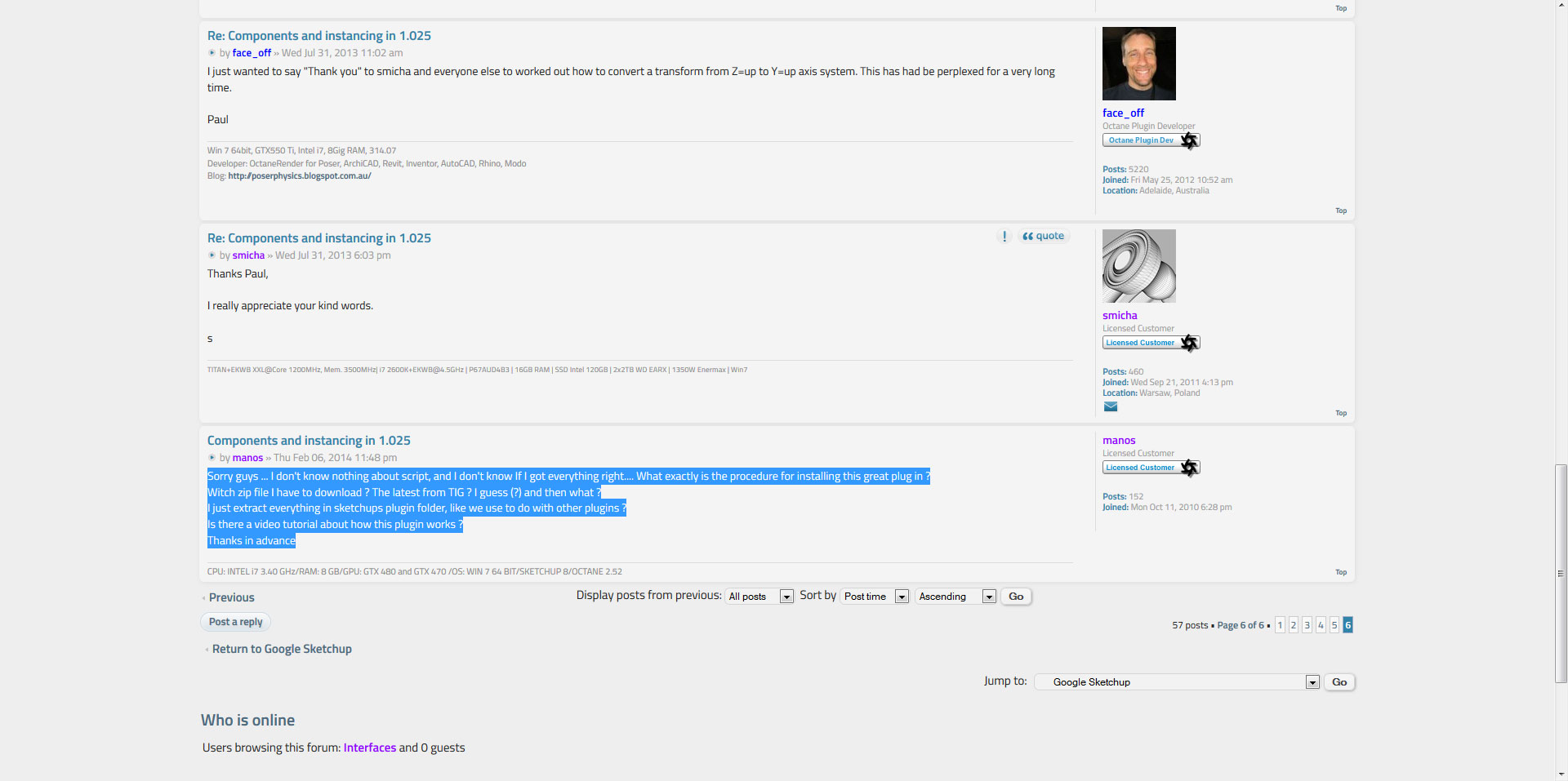

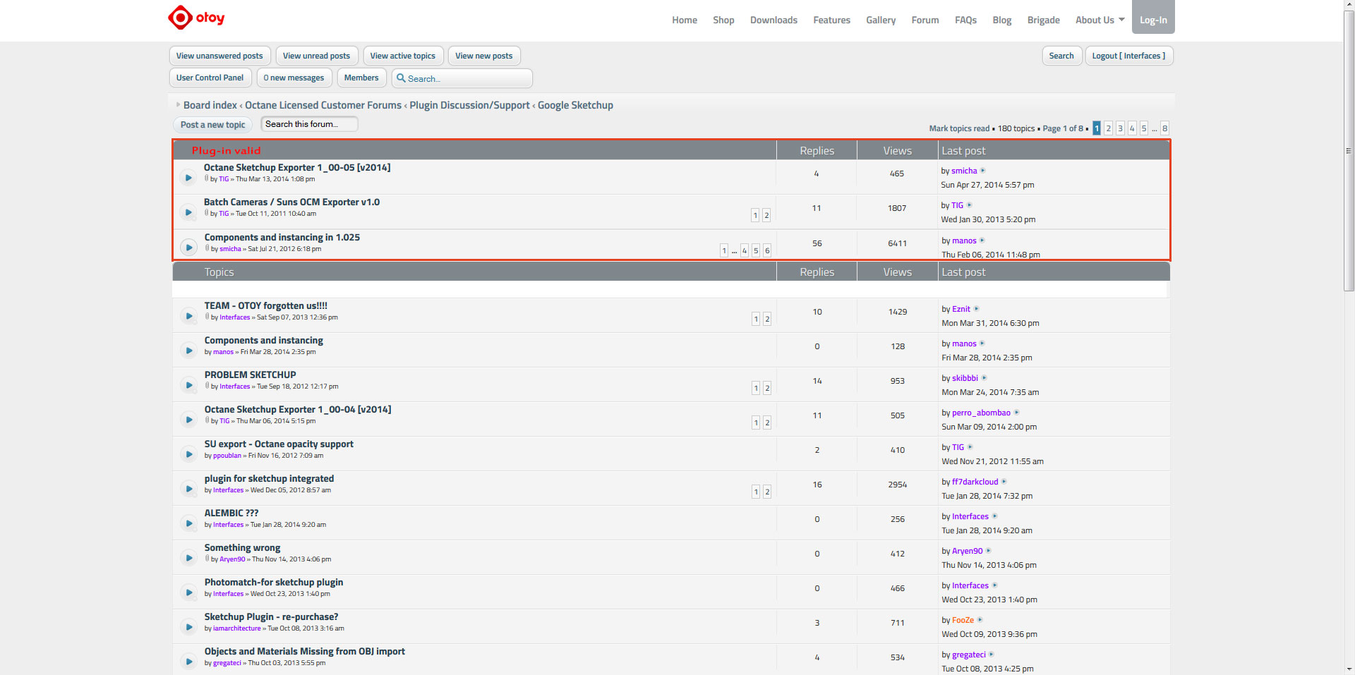

I have a request for better visibility forum for new come example: would be possible to put the valid plugin at the top of the list
see example: THANKS.
