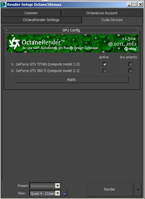

This is my current configuration :
I'm using 1 TGX 560 Ti for the viewport and 1 Titan for previewing ( +1 EVGA Titan Black Superclocked next Wednesday, hehe ), then both for rendering. Everything works perfectly !
