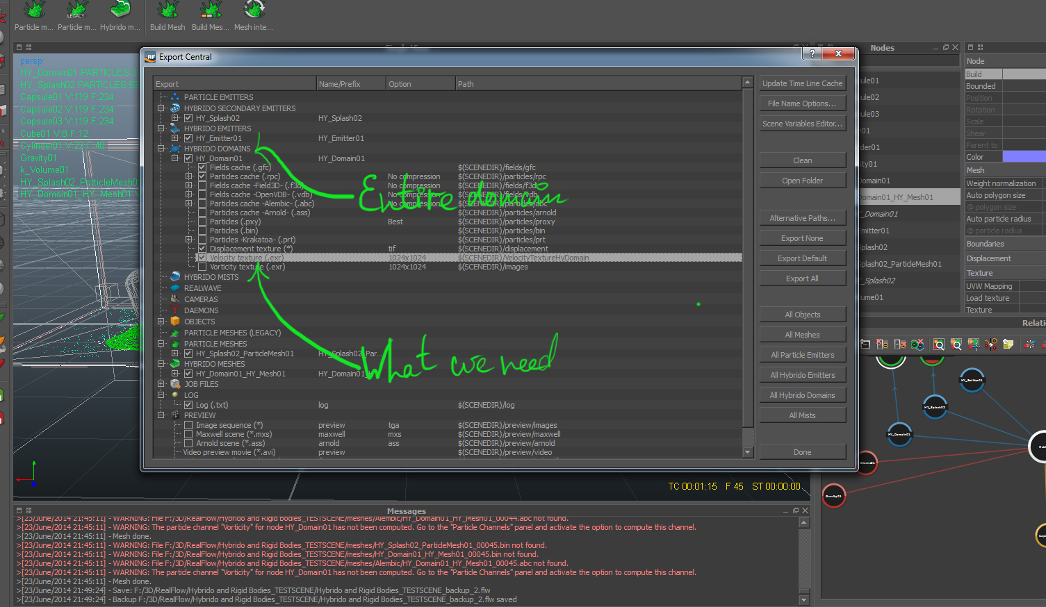

Found a solution:
You can simply export a velocity map directly from RF! Now after you've checked that (in 'F12' window) you can proceed with simulation of the fluid. I've got HY_Domain01_velocity_00####.exr sequence with cool colours :). They are applicable to the afterwards meshed model (Mesh's UV got to be set to 'Top Projection' as for RF 2014).
Feel free to bug me if you want to have RF 2014 to play with. I can only recommend it!
