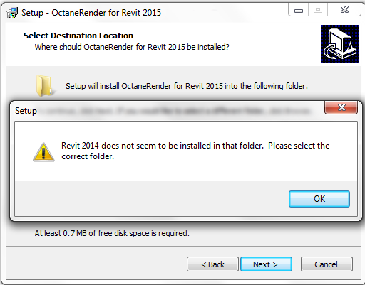

Downloaded link and received error message
The '2014' is a typo - and should read '2015'. Which version of Revit are you on? The installer assumes Revit Architecture, which should be in Program Files\Autodesk\Revit Architecture 2015. Can you tell me which folder Revit installed into pls?

Hi Paul, I am using Building Design Suite 2015 (Revit 2015)
I have previously been using Building Design Suite 2014 (Revit 2014)
and Octane loaded and worked fine.(was loaded in Program Files\Autodesk\Revit2014)
Program is loaded in Program Files\Autodesk\Revit2015
