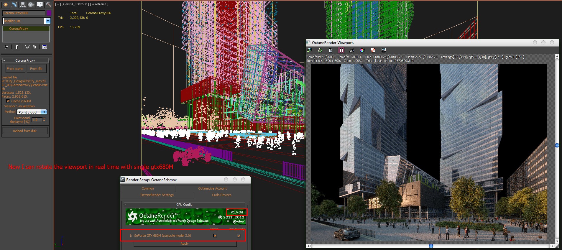

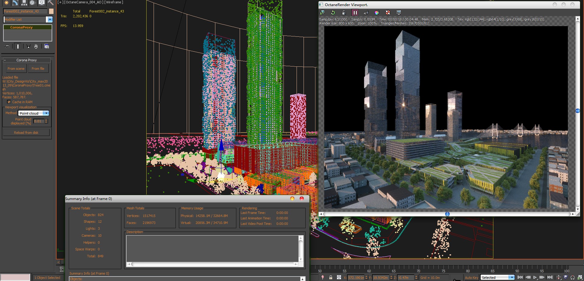

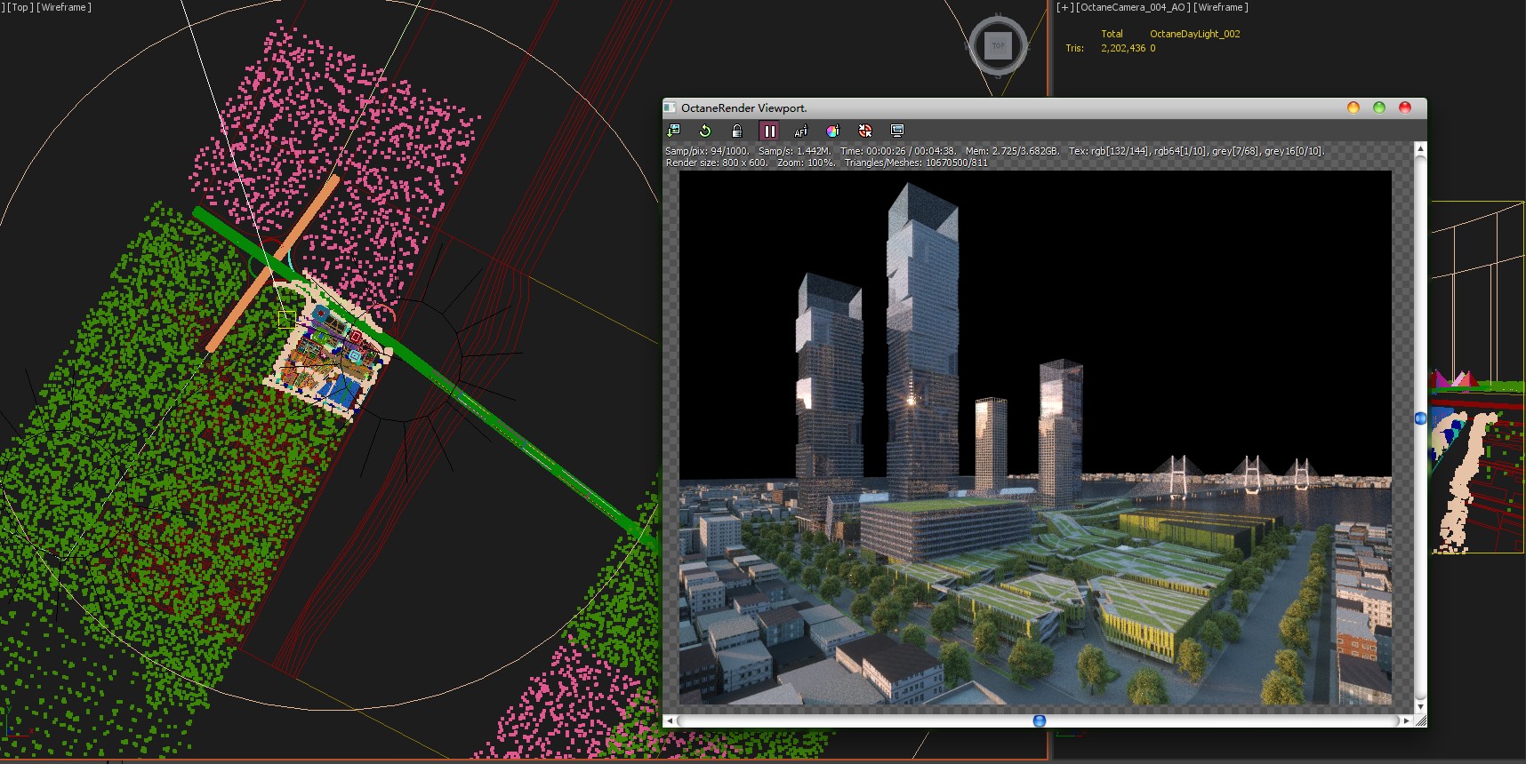

Hi guys,according to that corona proxy thing,please don't PM me,cuz It's Really Simple JOB!! I can't reply to you one by one :( :( so I post in here in case someone really interested in this !!Here I test in some real project using corona point cloud display option!! The converting job is really really simple,try following this:
1.Import a high poly object(such as tree) and then apply octane material to that high poly object
2.create corona proxy in object create panel
3.pick scene object(which will be that high poly object),and then pop up a window to save the .cmesh file!Go ahead give it a name and hit save to your hard drive(everywhere :lol: )
4.after u done this,you should see a proxy object with 0 face and the original high poly object(u can delete it now)
5.u can use some scatter script(such as adv painter) to populate the whole "set dress" progress,after u finish them,Ctrl+A select them all and check on "Octane movable proxy"
6.Done :) :)
Here are some screenshots of a real project! before I convert them into corona proxy,it's really impossible to rotate the viewport(much lag) with almost 2 Billions tris,look at this screenshot:
and then I convert those trees into corona proxy,the viewport become smooth and I can rotate in almost real time:
The great thing for this corona proxy things, is u can now save a really small size max file!!also u can never worry about the autosave in 3ds max(for a 2 Billions faces scene,it's really painful when waiting a long "autosave" time,and sometimes it may crash :cry: )!! but now everything changed :twisted: :twisted: :twisted:
The END :mrgreen: :mrgreen:
