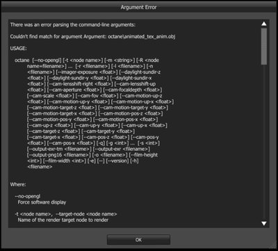

Hi Face, ok that makes sense. I am getting this message ... Do you know what that is ? Probably my fault ... EDIT .. I have tried two different scenes now and am getting the same type of Error message. So close yet so far Help Please

P.S. I just wanted to render out animated textures, is this the only way ?

Yes, that´s the only way.
The error looks like there are spaces in one path etc.
You can use the debug option to see the exported commandline in the script editor to see more...

Hi Face ... Yes, that's it !
Thank you so much :D

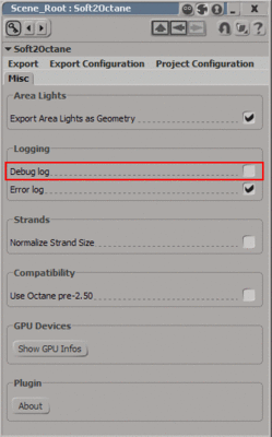

All I'm getting is ...
Sorry Face my bad, I didn't know where to look for error logs ...Back soon

You can turn the debug log on under the "Misc" tab in the Soft2Octane PPG ;)
