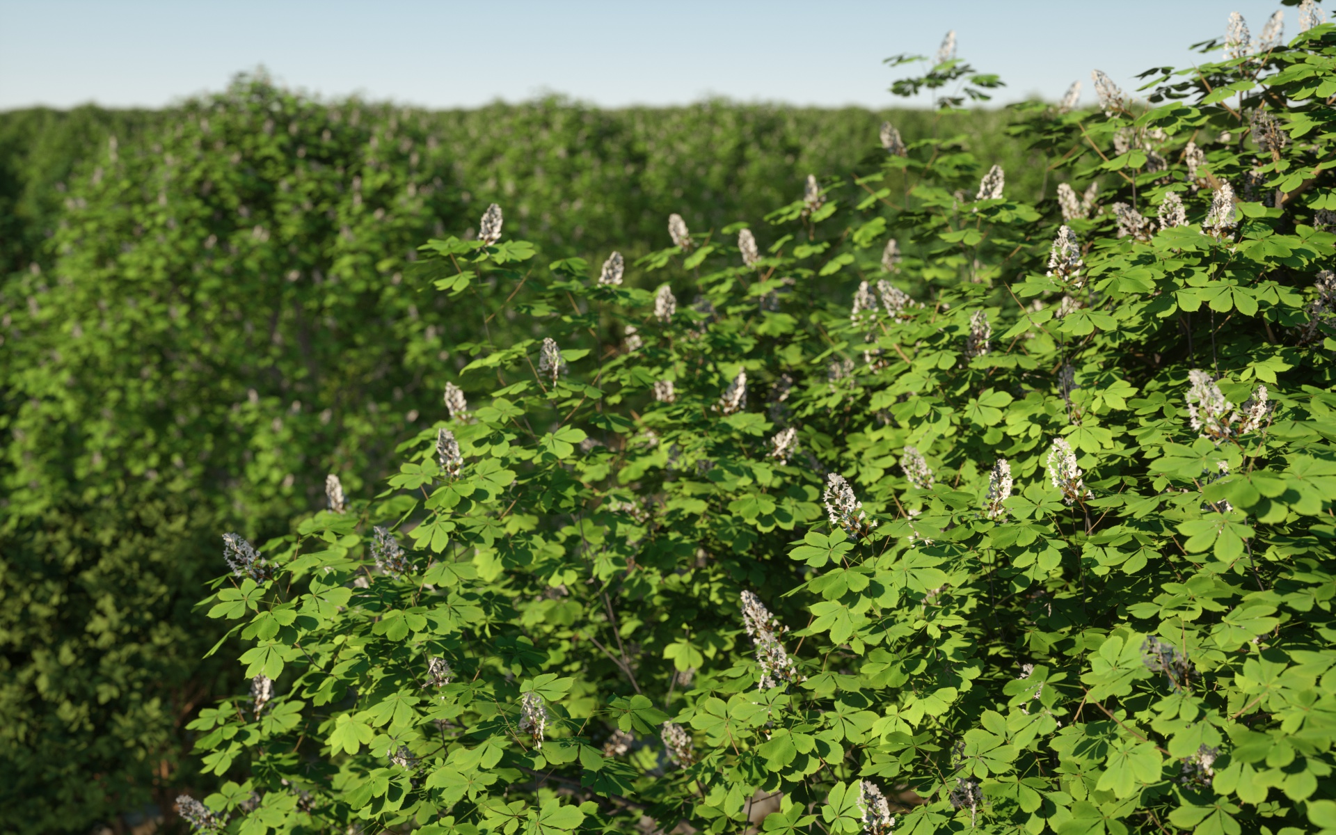

I got Laubwerk Plants generator. It creates great looking plants. Than I've put it into "cloner" and made a grid of 8 X 8 trees (64 trees as a result).
It hardly fitted in my 3GB GPU...
So after seing some animations with huge loads of trees and grass I have a question:
Is there any method of instancing which does not duplicate geometry? Or does it work in the way that never mind if using cloner or any other instancing method - duplicating this way any geometry just duplicates geometry and Octane sees it as any other geometry?
I just don't understand how do people create such complex scenes and run it on 3GB or 4GB GPU's???

hi, you need to activate the "render instance" option in thr clone object or in the instance object ;)
pay atention that only one level is possible in nested cloners, so if you have an instance object inside a clone object, only one of them must have the option enabled ;)

slepy8
Posts: 377
Joined: Sun Jul 14, 2013 10:53 am
holly sh***
I just made a forest!!!!!!!
thanks guys a lot!!
