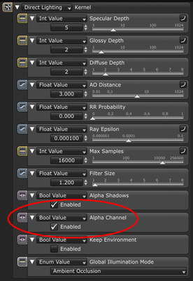

Hi there,
All you have to do is enable the alpha channel in the kernel node:

But make sure you don't have inverted normals on your imported meshes or it won't work.
