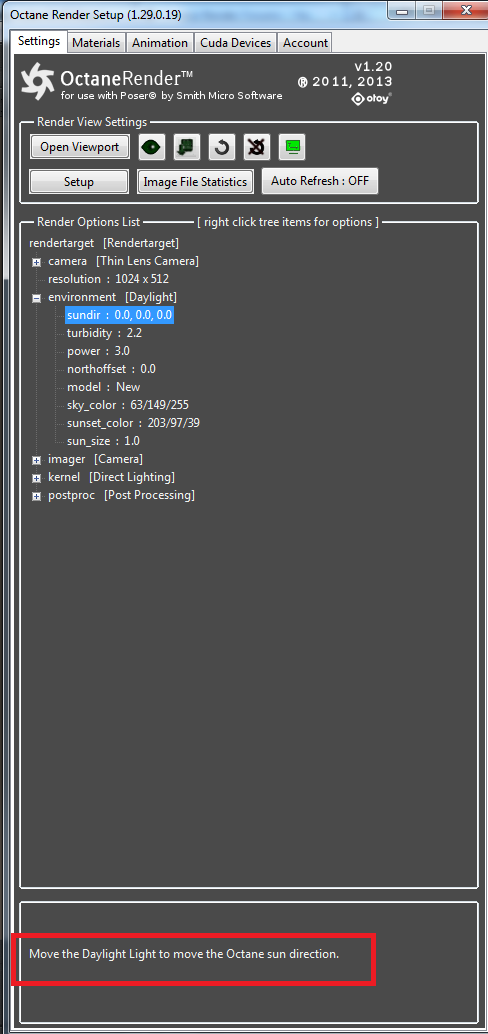

I encounter 2 troubles currently with Octane:
- 1st one since few months i'm not able to move the sunlight system (see attached files)

In order to move the "Daylight" (aka sundir), you simply move the light called "Daylight" directly in your Poser scene.
Usually (if things didn't change), the plug-in renames the very 1st infinite light in your Poser scene to "Daylight", which you then just move around. The values then get transferred over.
You can not move the "Daylight" directly the plug-in.
Hope that helps =)

Thanks Erick didn't known that Octane was linked to the Poser's lights.
