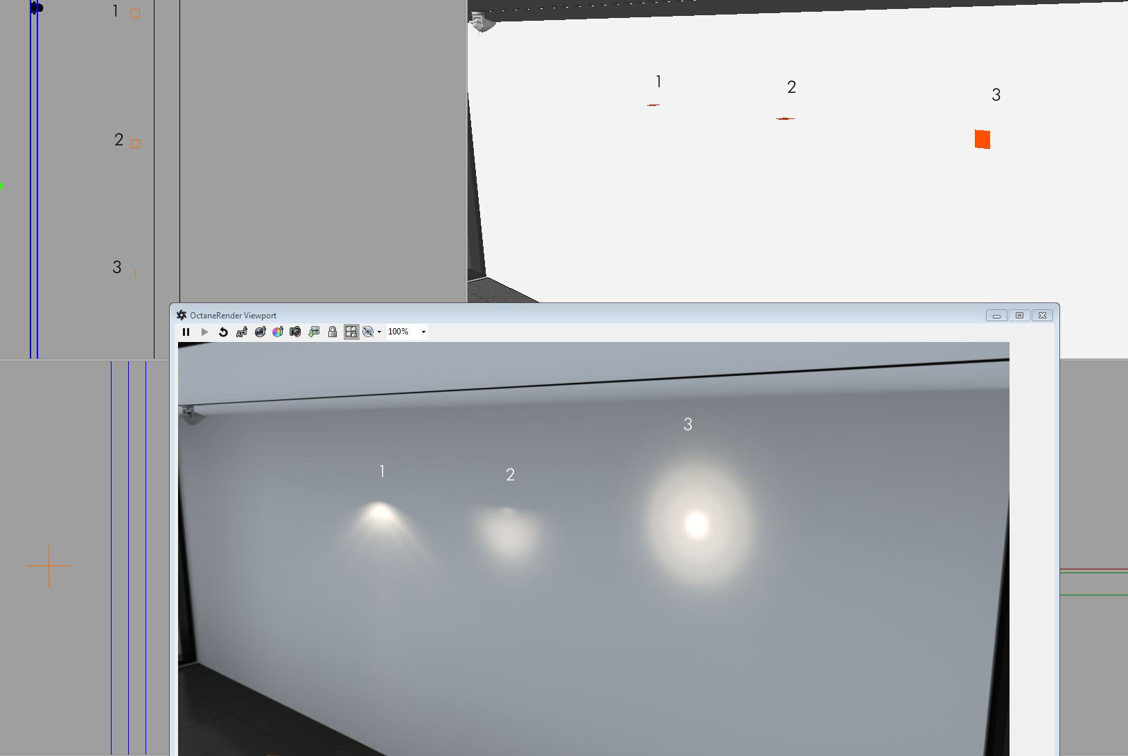

Hello Paul,
thank you for your feedback, attached please find a picture of tree emitter planes:
1. Plane facing horizontal downward, IES orientation of the material 0,0,0
(Projection spherical/3D transformation / rotation)
2. Plane facing horizontal downward, IES orientation of the material 0,0,90
3. Plane facing vertical 90 degrees, IES orientation of the material 0,0,90
As you can see, the surface is affecting the IES distribution when it is not physically orientated the same way as the material orientation.
So imagine a room with 10 spots which are supposed to illuminate 10 pictures distributed all over the room...
Right now you would have to do the following:
1. orient the lamp geometry (usually a block) towards the pictures, write down all the angles of each lamp.
2. create 10 different materials, one for each lamp...
3. place an emitter plane in front of each lamp, orient each emitter surface according to the block orientation.
4. assign one material to each of the surfaces, key in the specific angles for each lamp...
Maybe I am missing something, but the process above seems very cumbersome to me, not to mention the fact that you have to alter 10 materials instead of 1 e.g. when you change the intensity of the lamps.
So my wish would be that the IES orientation could somehow be connected to the lamp orientation.
This way you would :
a) ...only need one material instead of 10
b) ...be magnitudes! faster when changing the lamp orientation (you would simply rotate the lamp and that is it)
I am no programmer, so I am not aware if such a thing is possible at all (I really hope it tough...)
or how difficult it possible is to implement.
best regards
Andreas

Ok... I think I found a solution myself...
1. I created a lamp geometry with the spot facing down, created a line through its center for better aiming.
2. created a plane in front of the spot
3. assigned a IES emitter to the surface, default orientation 0,0,0
4. now I block the whole arrangement.
now I can rotate the block in any direction - the IES profile is picking up the new orientation and follows the geometry like expected!
PERFECT! :D
