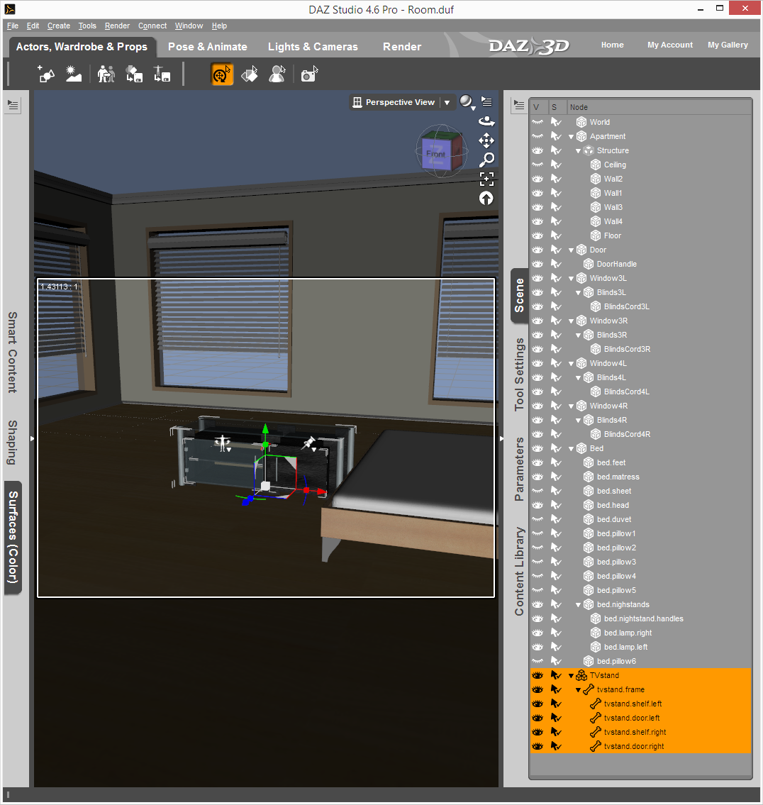

I just noticed that just by merging certain poser props into DS will cause a good scene to start duplicating mats like I reported earlier.
It appears that poser props with the bones trigger the bug... :?:

vortex3d wrote:I just noticed that just by merging certain poser props into DS will cause a good scene to start duplicating mats like I reported earlier.
i have already found the reason and most probably fixed it. need a few hours testing with all the various import/load scenarios.
btw _this_ above is an expected result: materials will be only grouped by their skeleton*) root object - so adding a skeleton prop twice into a scene will also result in of course identical materials for both of them. the bug was that this did indeed also happen when loading a scene thus overruling the previous setup.
*) the limited grouping is mostly targeted at figures or i.e. hair props, where you usually like to have mats separated per figure, even when they are identical at the beginning, but it therefore also happens with props that are set up as skeletons...
