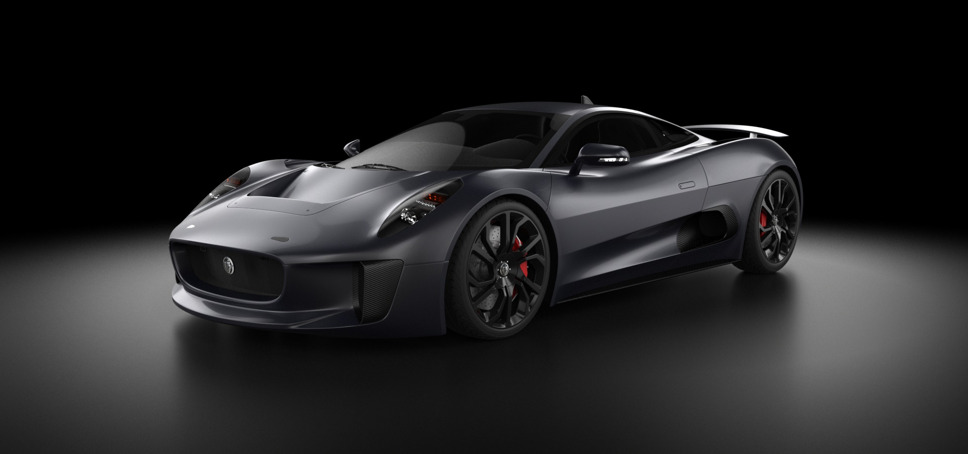

Hi dotcom,
maybe you give the Car Environment Setup i attached a try. The image is rendered with this setup with one single GTX 680/ 4GB for testing purpose.
I dont know how to compare it to your 740M, but it took approx 5 minutes to get the result you see here.
For faster renderings you can switch from DL diffuse to AO, it will render much faster.
If you change the HDRI, you will need to tweak some materials.
To get even faster results, you can use a denoiser like neatvideo or else to get rid of small grain that appears on glas sometimes.
cheers, djart
