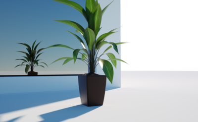

Hi Karba
I am trying to use difuse transmission, but it seems to have a problem with the reflection of the leafs in a window when i use it...
When difuse transmission is enable, the reflection of the leaves becomes grey...
Can you help me with that?
Thanks a lot in advance
Layla
Layla

- Layla_Bressler
- Posts: 16
- Joined: Thu Mar 21, 2013 10:32 pm
- Location: Brazil
Here is the problem...
Layla

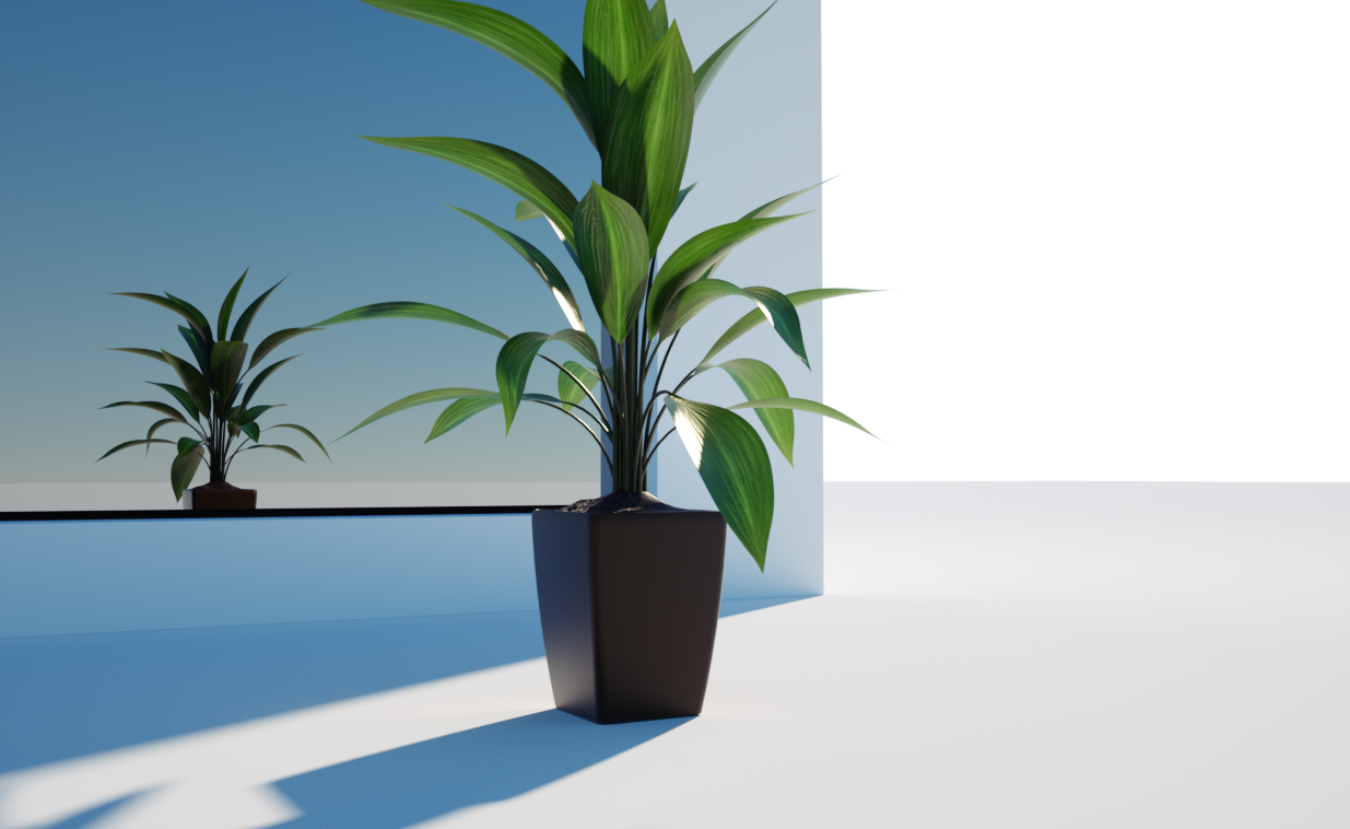

i did a sample, i hope can be helpfull.
you need 1.29 or newer standalone to open it

- Layla_Bressler
- Posts: 16
- Location: Brazil
Thanks a lot Aoktar
Beautiful effect... very nice
I am using the 3dsmax plugin ver 1.2
Ill try to reproduce that today...
Regards
Layla
Regards
Layla
