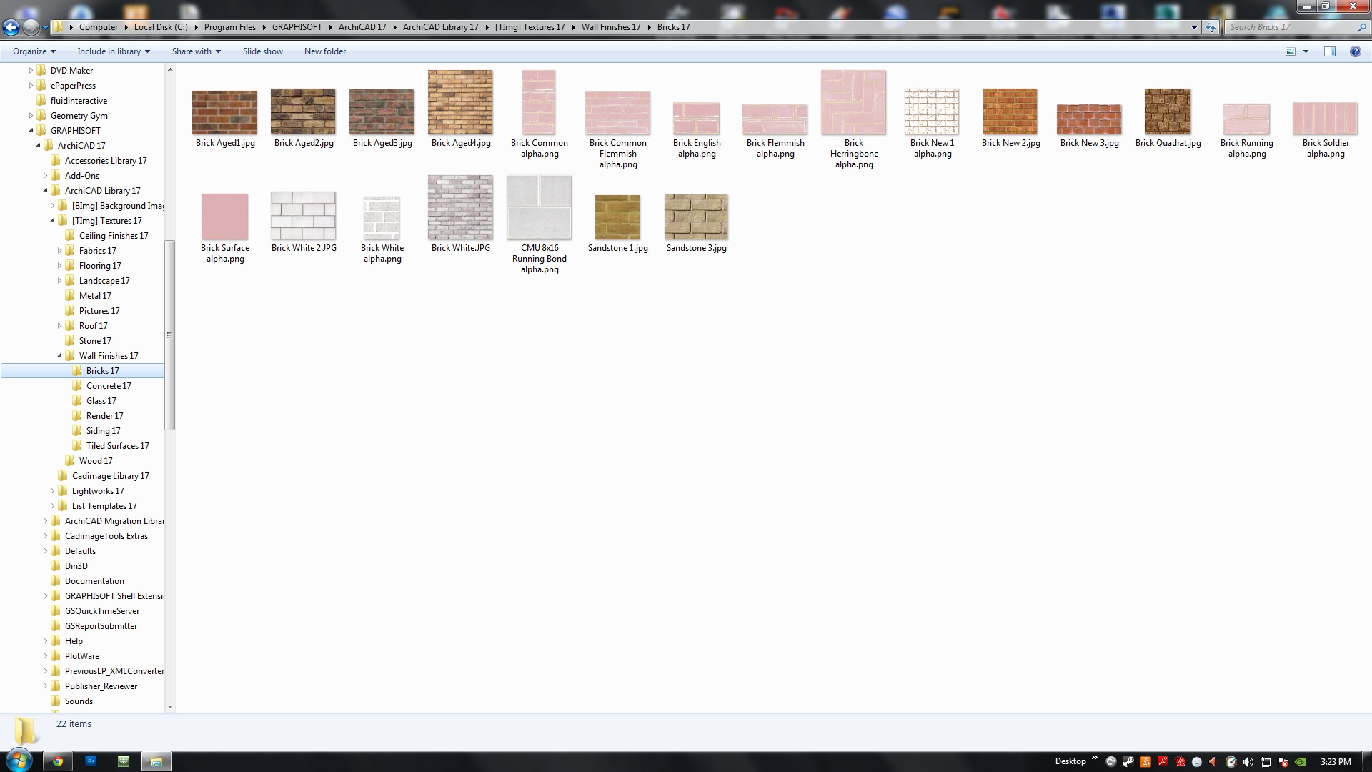

The error messages are indicating that the texturemap C:\Program Files\GRAPHISOFT\ArchiCAD 16\ArchiCAD Library 16\[Img] Textures 16\Wall Finishes 16\Bricks 16\Brick Running Alpha.png is missing. Is that file on your hard disk? Are you able to provide a screenshot of the C:\Program Files\GRAPHISOFT\ArchiCAD 16\ArchiCAD Library 16\[Img] Textures 16\Wall Finishes 16\Bricks 16\ folder pls? You can see my ArchiCAD install below has this file.
Based on the error - I would guess that the above file is not there on your PC, so it is not possible for the Octane plugin to file that file.
The situation would have existed in the old plugin (1.20) too, so it's odd you weren't getting these error then. Has anything else changed?
Also, can you post a screenshot of your File->Libraries and Objects->Library Manager screen with the '+' items expanded.
Paul

do i have to reinstall archicad 16 so that the plug in can find the missing texture?
I think what is happening here is that when running the plugin on AC16, you've saved all material as a "Default" and those defaults are referencing the AC16 folder and not the new AC17 folder. So you can:
a) Reinstall AC16 to get these texturemap files back on your hard disk (do this option if you have a highly customized set of Octane material defaults that you do not want to loose), OR
b) Delete all your default Octane materials (delete all files in C:\Users\[username[\AppData\Local\OctaneRender for ArchiCAD\Defaults)
I need to add a function into the plugin to automatically change all the AC16 references to AC17.
