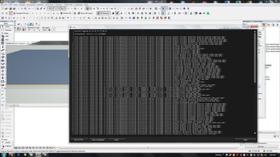

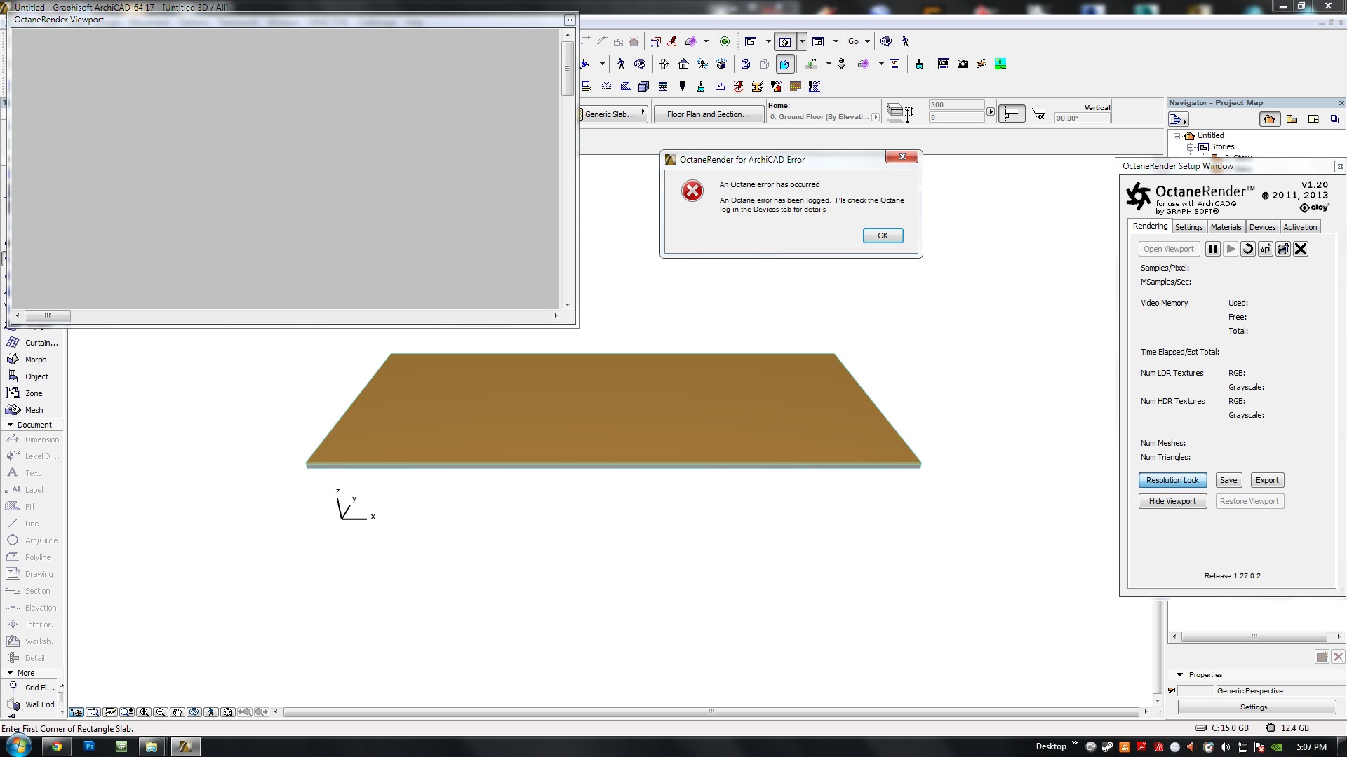

Hi Paul, after I installed the latest update I encountered the following problem
Windows 7, Intel Core i7 @3.40 GHz, 16 GB RAM, 2xGTX 580

It looks like your scene is references texturemap files which do not exit. Is this happening on every scene, or just one? Have you checked to see if those files are in the locations listed in that error log?
