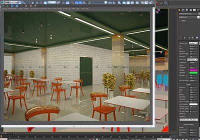

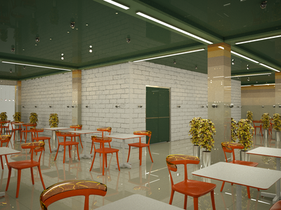

Octane render 1.18 for 3ds max 2014
all the noise
64 000 samples ((((

Try to increase the caustic blur parameter a bit. The combination of very smooth surfaces and small emitters is not a strong point of Octane.
And if you post a render showing a problem with noise, always switch off hotpixel removal (set it to 1.0), and make sure zoom is at 100%, this makes it much easier to see what's going on.

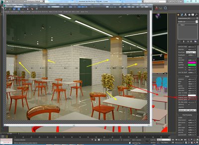

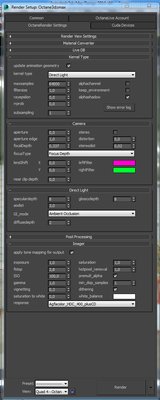

caustic blur no such function
the same direct engine ambient occlusion

roeland wrote:Then you may have another problem. Can you post an image without zoom and without hotpixel removal?

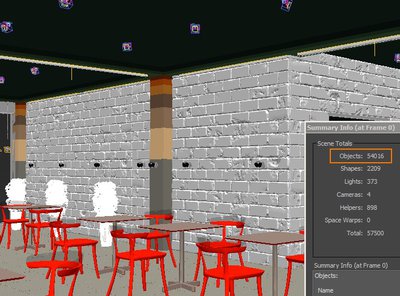

sorry, but this is insanity
r9 3900x/64Gb/2070s/2070/win10x64/3dsmax2021
There's too much of lights & too much of unnecessary reflections - surfaces are unreal to say at least - You can't avoid noise or ff here making unbiased engine running in circles. Optimisation is a key if You want to avoid these. On the other side, there's no need for 32k at all - render 2x or even 4x resolution and downscale removing noise in post - much more time effective than leaving software to deal with scene like this.
P.S. Scene is a headache - I couldn't even start to render.. - seems like someOne exported it from diff software and try to render it out as is - optimisation is badly needed..
ditto. too many reflections. The engine doesn't stand a chance.glimpse wrote:There's too much of lights & too much of unnecessary reflections - surfaces are unreal to say at least - You can't avoid noise or ff here making unbiased engine running in circles. Optimisation is a key if You want to avoid these. On the other side, there's no need for 32k at all - render 2x or even 4x resolution and downscale removing noise in post - much more time effective than leaving software to deal with scene like this.
