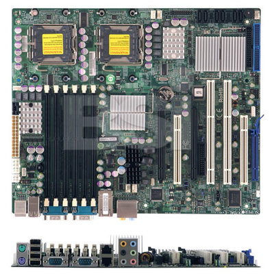

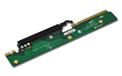

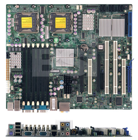

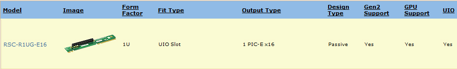

Hi i have a question:
i have this motherboard (X7dal-e+) can't support 2 pci Ex16 but i found this slot espansion..
Can i whit this slot add another Vga? Maybe to use dedicate for video navigate only...
Sorry for my bad english...

that does'nt look like an expansion slot, just an assembly to mount a PCI-E card in a low-profile case.
it's not what you need. ;)
