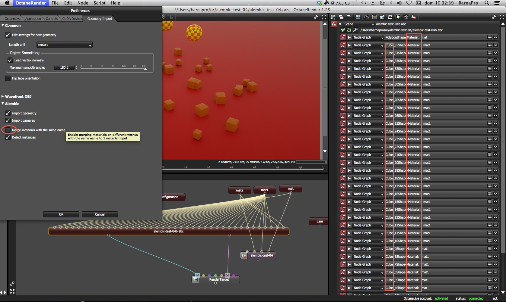

Posts: 10564
ok, finally i have figured out, the issue was not the c4d alembic exporter, but my brain :)
deactivate the option "Merge materials with the same name" in the octane's alembic import preferences, works also with c4d-alembic files, sorry for the mistake :(
anyway, seems that the option works with the suffix "Material" in the objects names, so the result is always only one pin for all the materials.
Could it be possible to add a second option that looks to the prefix of the object name? otherwise the node-graph seems again a spaghetti-madness even with simple scenes :roll:
I need to make some more tests because the "Detect instances" option doesn't work as i expected :roll:
