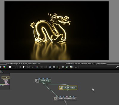

Hello! I'm strugling with this very simple problem, I need to apply the falloff node to a emiter via textured emision node but I need to invert the value (brighter in the middle, darker outside) but the invert node deosn't do the job, neither the clamp node with max value = 0 and min =100.
Any idea?

This is a good question. The same problem is there in the Standalone app. Anybody know why? ... perhaps you should ask in the main forum.

This is because although the emitter is darker at the edges, it is still bright enough to saturate the image. You have to decrease the power of the emitter and decrease the skew factor to have visible dark edges.
