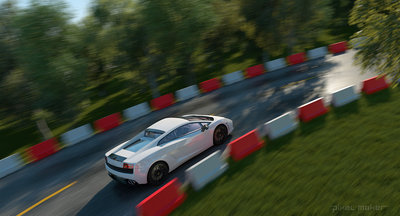

My first try with Multi-Pass Motion Blur from max.
30 samples (i need more for a smooth result)
5000x3333 px on 2 x Titan (6 hours to render)
PT 7 bounces.
Scene created with raiclone for road and railing, and multiscatter for grass and trees.
HDR light.
Lamborghini Gallardo with Multi-Pass Motion Blur

Nice image! =) a bit of color correction, few small details & it would be perfect! =)
it reminds me some photographs I've really like from http://www.harniman.com/
check his website for inspiration - He's worked for brands as Bentley, Jaguar etc..

thanks glimpse,
yes, very nice for inspiration.
This is my first try, for the next one will try to make some more landscape for the scene.
I recently discovered the posibility to render with motion blur, even if this means to use multi-pass (hope that soon will no longer need that
I kinda like automotive render, even photography (a few days ago i made myself a custom car rig so i need to do some more stuff)
Maybe in the future i'll integrate some cg scenes in car photography.

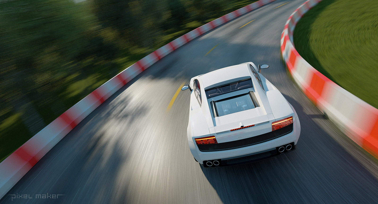

another view

really cool!! so the still render took 6 hours or the animation?lixai wrote:another view

6 hours With 2 GPU ? You should reconsider your workflow. Octane is not that slow. You must be leading Octane to calculate something that it shouldn`t.
Win7 64 & Slackware 14 64 | 3x Zotac 580 amp & 1x MSI 680 | i7 3930K @4.8 | 32 GB | Asus rampage extreme IV
@karanis & solomon, yes, one render took 6 hours, I rendered 5000x3333px, 30 prepases (with motion-blur takes around 2.5 times more that a normal render)
My scene consists only from geometry (trees and even grass ) and as you can see it has difuse sss, so it's taking longer this way.
Yes I am not verry happy about the speed, but this is my starting point, hope we will receive real motion blur soon, and renders will take 30 minutes

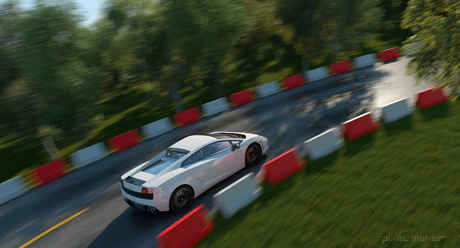

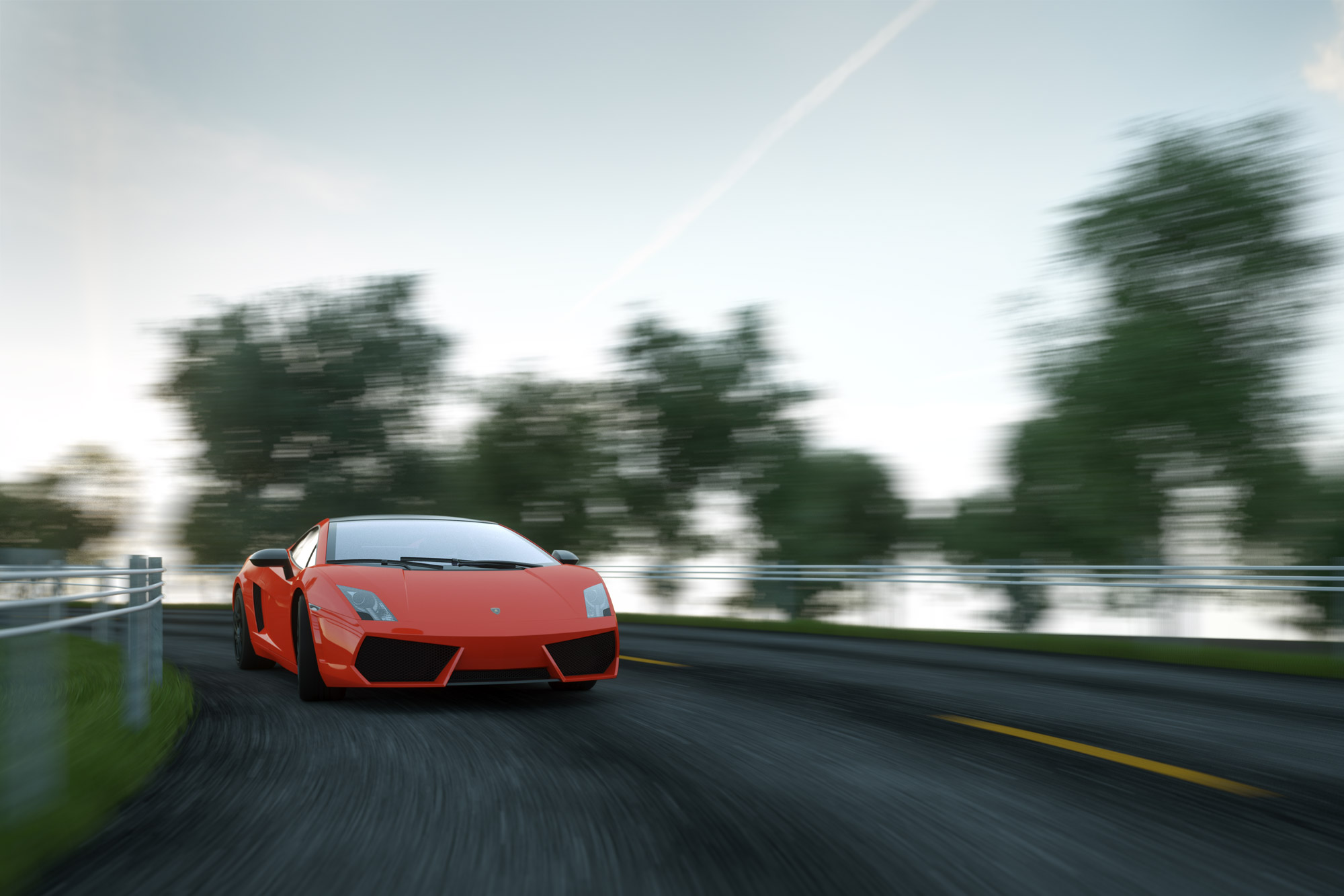

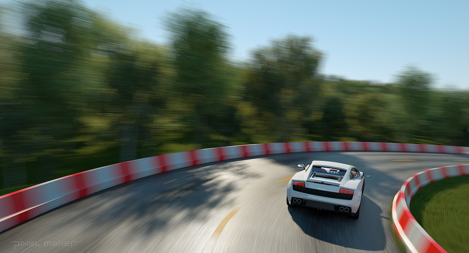

Here are some more cameras.
