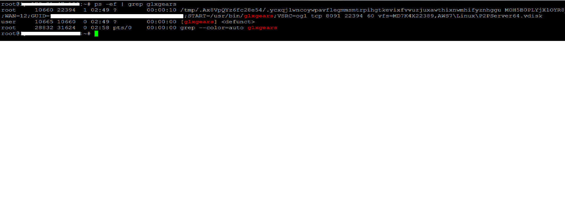

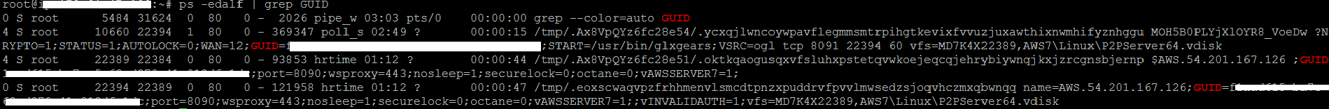

Postby thegoldrush » Fri Dec 13, 2013 3:21 am
thegoldrush Fri Dec 13, 2013 3:21 am
When I type in the following url http://aws.otoy.com/?connect=//<Public DNS>:8090/?NOCRYPTO=1;STATUS=1;AUTOLOCK=0;WAN=12;GUID=<GUID>;START=/usr/bin/glxgears;VSRC=ogl I get a complete blank screen.
I am using a Ubuntu game console. Usually the glxgears should show up in the browser but I get a blank screen. I sshed into the G2 instance and found the following output.
and
It would be great someone could provide a clue about what is happening here.
