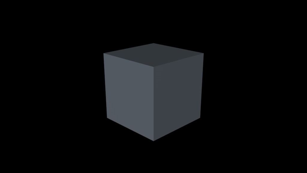

Concerning the offset problem I experienced:
I got mixed up with versions. First time I saw the offset happening was 99e. The version we had installed before was 96. That rendered a matching image. Somehow I don't think that it's a user error. I just opened the old scene, hit render again and the offset was there. Attached you can find a c4d scene with simply a cube in there. As soon as you add an Octane Camera tag to the camera the offset happens (with default values in the camera tag as well as any other settings as well)
(The blueish cube on black is c4d AdvancedRender, the brighter image is Octane)
