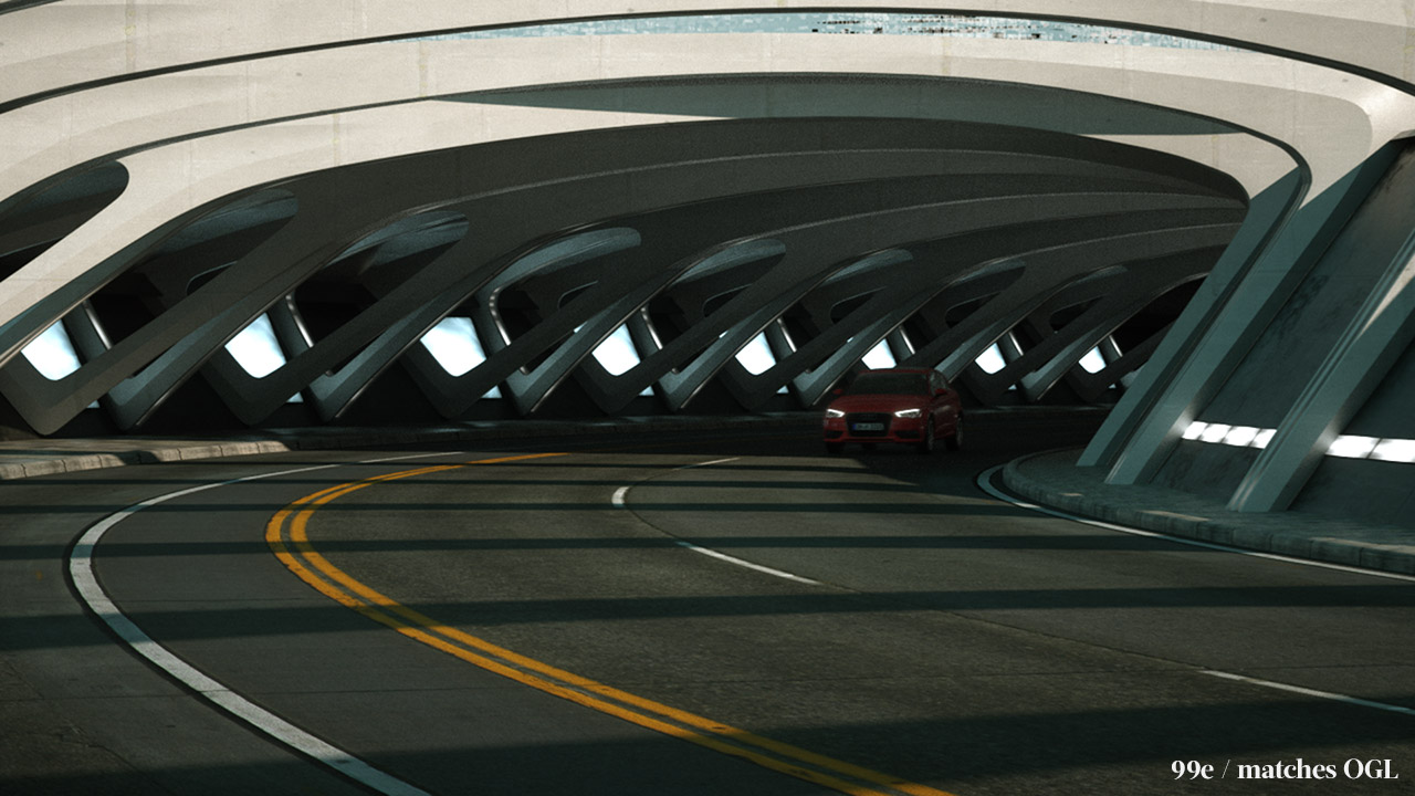

99f introduced an offset in the rendered image. It's a 2d offset which can be fixed by moving the layer in aftereffects/photoshop to match the position of the old render (you're missing the edge pixels of course).
Render of 99e looks as it should and matches cinemas viewport, 99f moves the framing to the left and down.

Augustronic: there is no different in codes to cause this. Only dll loading function is updated. Can you be sure there is no user mistake?
