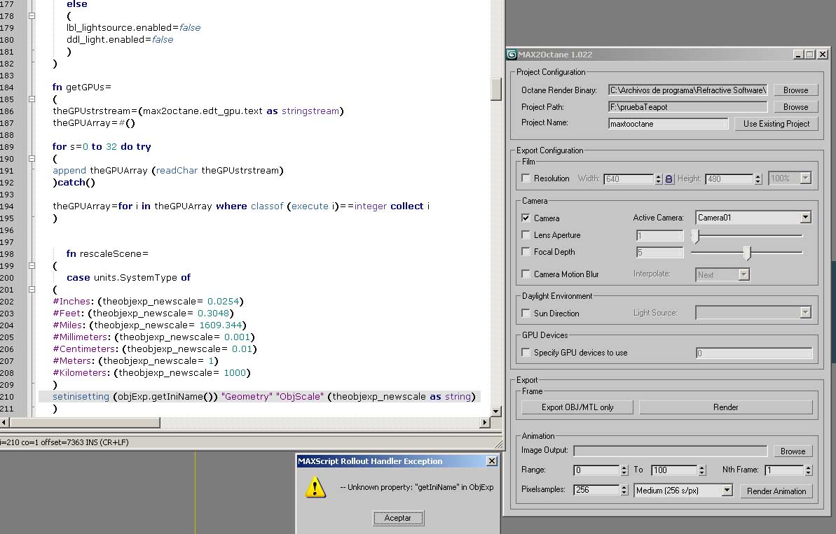

I get this on max 2009, pressing either Render or "Export Obj Only"
Win 7 64bits / Intel i5 750 @ 2.67Ghz / Geforce GTX 470 / 8GB Ram / 3DS Max 2012 64bits

Noted, will upload fix ASAP

Updated script (1.022b) available for download in the second post in the thread!
Hello
nice... now I can export... but the render/animation buttons do not open octane, i linked it correctlykilaD wrote:Updated script (1.022b) available for download in the second post in the thread!

What was the problem with the buttons?
