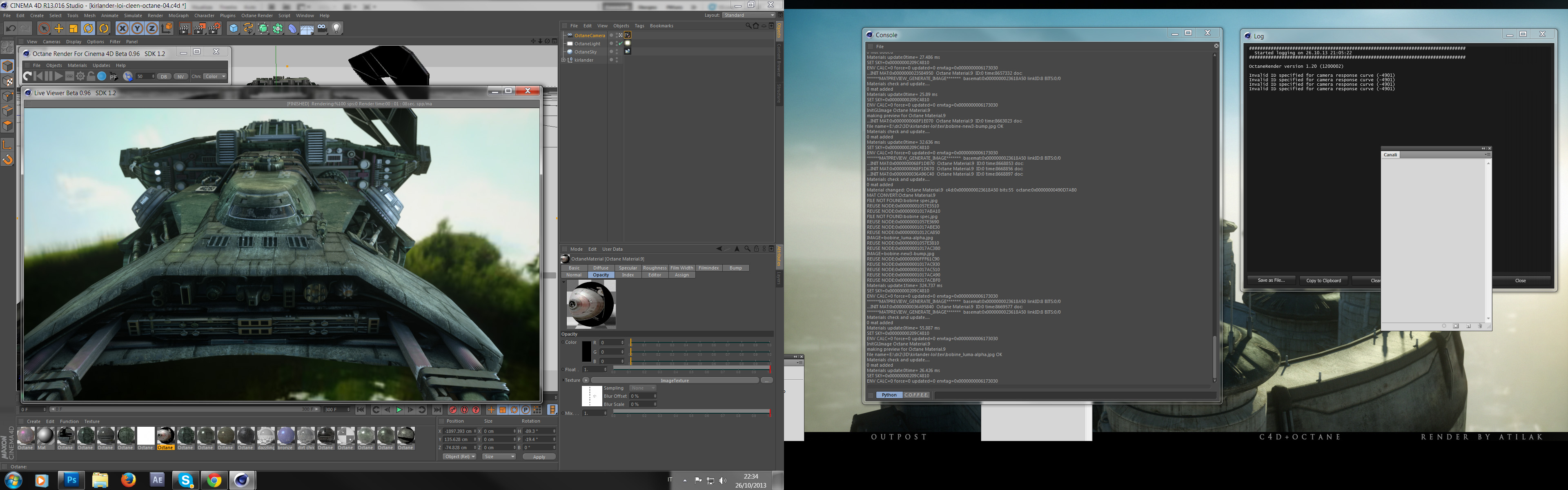

An for stopped animations:
I doubt from power settings or Win8. Can you try with power saver is disabled and don't allow pc to sleeping. Also use this settings before rendering and leave opened this Console window to see render progress. As I described in first page
http://render.otoy.com/forum/viewtopic.php?f=30&t=36331

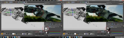

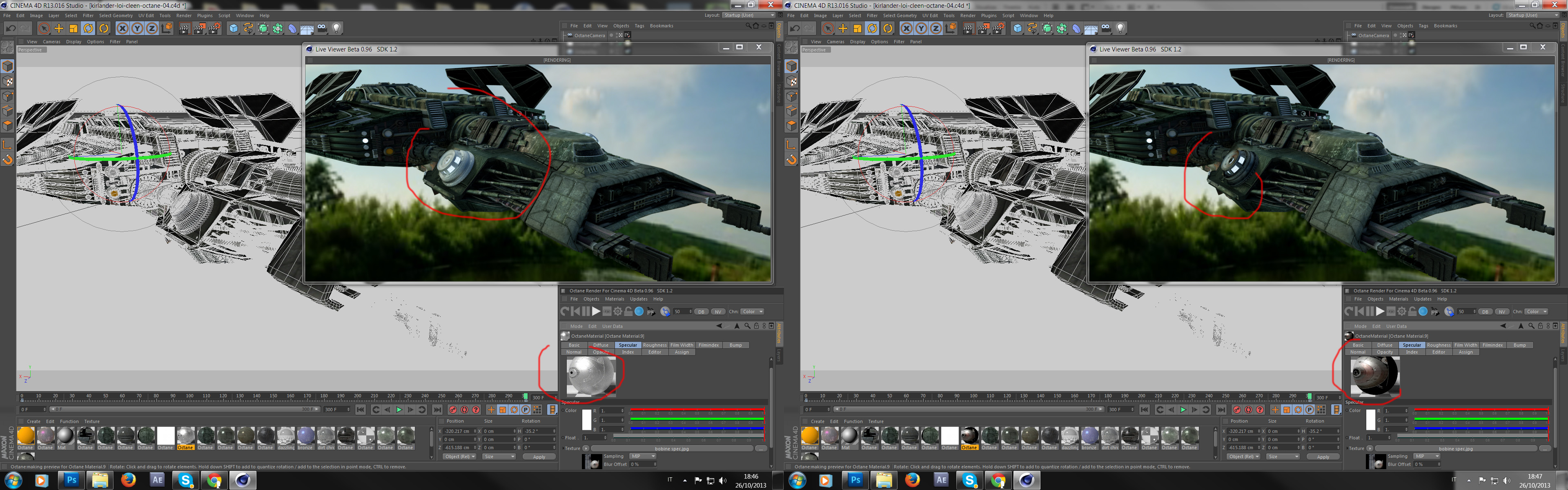

I have found very strange bug.
One is the instability of a shader. One of the materials of this scene, occasionally changes. it is as if the channel (specular) went out. After refreshing the texture, everything returns to normal, but only for a while '.
Another problem really strange, you can not perform animations on the z axis. The button to create the keyframe creates a key, but no changes are made.
The scene crashes often. I attach one of the bugreport.

did you get any error message? Please show me log outputs. As i pointed in first pageatilak wrote:I have found very strange bug.
crash point is on sending of mesh data. There can be a problem with mesh.atilak wrote:I have found very strange bug.
seperately, i see a error, it says "texture not found" for "bobine spec.jpg". is this in same place with others? what is your texture sizes? is that very big?
for anim. problem, i don't think that's related with plugin.
