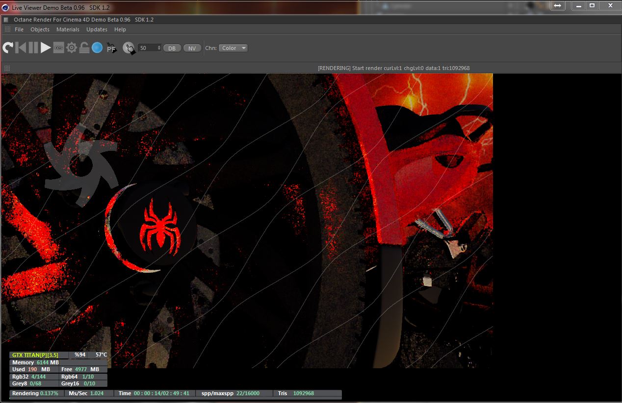

Very excited to see the changes and progress! I know this is demo version but I have never had this in your other beta versions. There is a demo watermark over the render?

buzby wrote:Very excited to see the changes and progress! I know this is demo version but I have never had this in your other beta versions. There is a demo watermark over the render?
i think that you download wrong installer?

Yup, slip of the click! I was just looking at the version numbers Thanks :oops:
