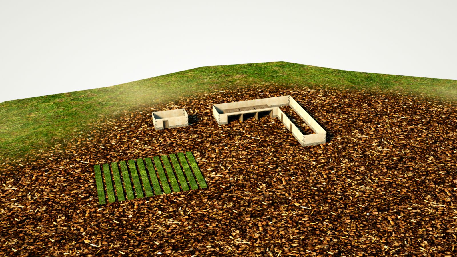

Hi everyone,
I'm having some trouble with the SLICE modifier and its rendering using the current V1.18 exporter.
I want this building to be "building up" from the ground, so I applied a Slice modifier.
The problem is the following :
Sometimes the slicing makes all my materials disappear.
Any help would be much appreciated...
Cheers !
[EDIT] I just tried launching the animation : it NEVER works while it's playing. It works sometimes only when you "play" with the Slice gizmo in the 3DS viewport" [EDIT]
[EDIT #2] When you press "Play", watch the animation, then press "Rewind from start" and play again, it seems to be working 3 times out of 4. Still, it's not very stable...
[EDIT #2]
