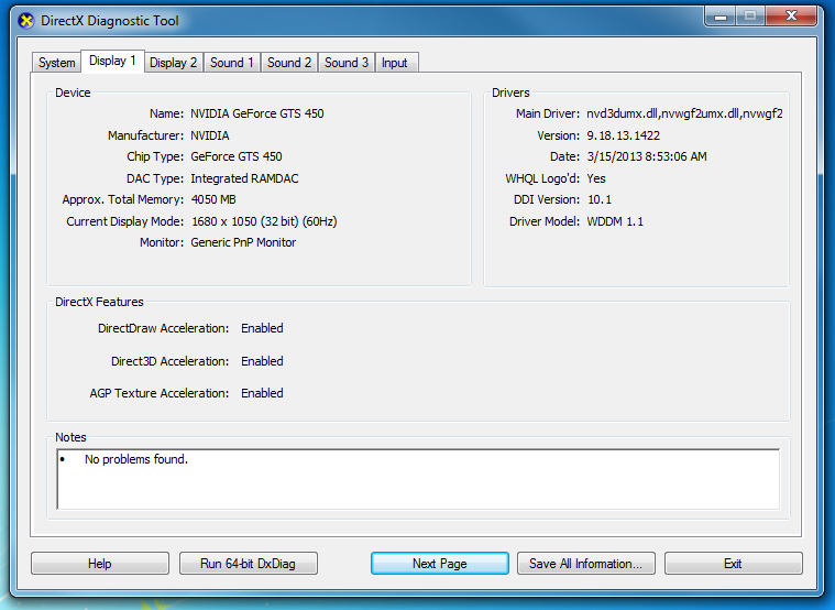

Hi Paul,
This is what I get when I run dxdiag, I don't know much either.
I will try some other card and let you know
face_off
Posts: 15736
Location: Adelaide, Australia
If you run the plugin on a simple scene, it will give you the scene and memory statistics at the bottom of the viewport. Could you post a screenshot pls. Also, the memory message you are getting on the big scene - can you post a sceenshot of it pls? That would greatly assist me determining exactly what is happening.
