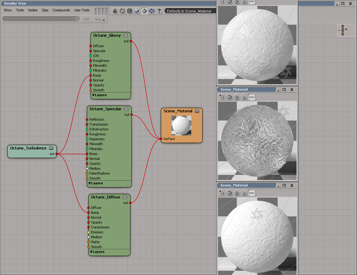

You can simple plug it in the bump slot from the 3 Octane materials.carlos wrote:Face (danke)
thanks for the fantastic job, a realy good integration ind softimage,
only a question where I can mondify the bump-operator.
thanks in front and best regards
You can modify the strength by change the power from the texture. In this case the power from the Turbulence shader.
